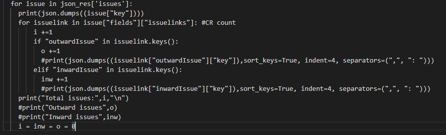

Hello @Toby Moore
There are different kind of links, in my below code section you could see a code that counts the issuelinks and then it could print any issue if required but I commented that section.
This is in a for loop so it will perform this till all issues are being printed/counted or classified.
Line 1: This is going to happen anytime for each issue in the response (I'm getting a response with more than one issue and each issue could have linked issues)
Line 2: I'll print the issue key (The list of issues I got will be printed one by one)
Line 3: I'll count the linked issues for each issue contained in the response (firs loop), Once I printed the issue the links will be counted for this.
Output example:
KEY-1
Total issues: 15
Last Line: I restart the issue counters, and the loop continues.
