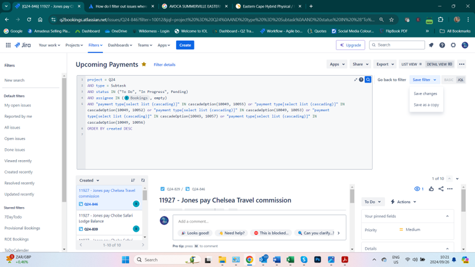

I am writing a filter where, amongst other criteria, it filters out issues that have status done. Here is the revelant part in JQL. It still shows issues where status is "Done".
project = Q24
AND type = Subtask
AND Status IN ("To Do", "In Progress", Pending)
AND assignee IN (712020:c1a9d850-96c8-4116-8180-8c436b0e59f0, empty)
What am I doing wrong. I also tried negative statement, NOT IN "Done" and it did not work either

Hello, Good day. I don't see you have used 'OR' anywhere and only "AND' is used. Is it possible for you to share a screenshot ?

You are using 'OR' in this JQL that is the reason. Create the JQL only with 'AND' function, this should help. Thanks

Evgenii
September 26, 2024
You have many OR's in the end of JQL, for payment type field. They are messing  with all other query conditions.
Write your full JQL, we can correct it.
Here is similar question, where OR changed results (and way of fixing it)
https://community.atlassian.com/t5/Jira-questions/Filter-creation/qaq-p/2817859#M1053180

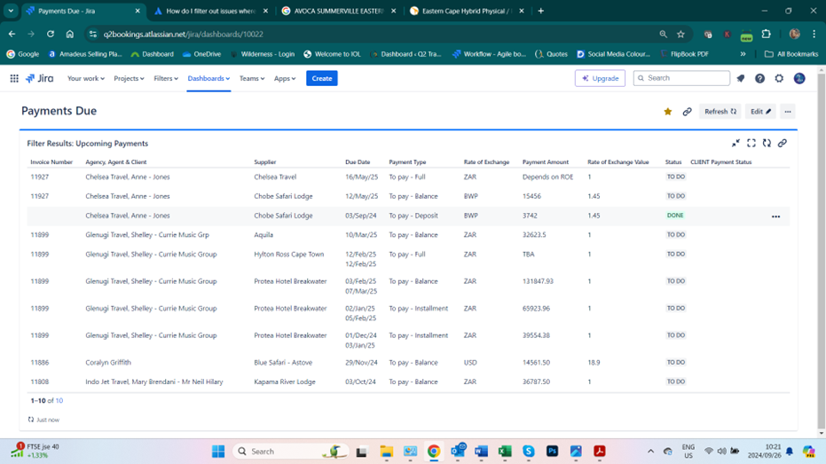

Duane Steyn
September 26, 2024
Hi.
I have tried the following:
AND status != Done
as well as
AND status NOT IN (Done) as well as positive IN statements and it does not filter out the Issues that have status done. I have attached screen shots on Mohanraj's post below.
