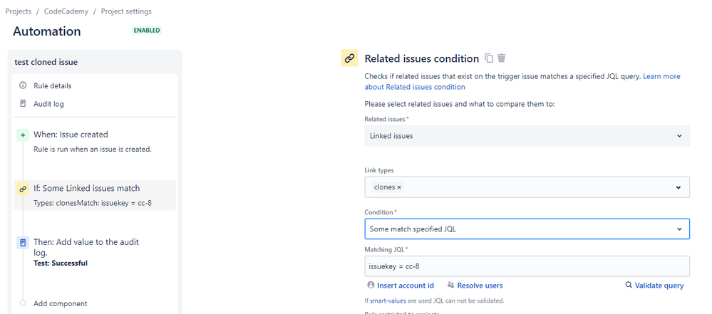

I'm trying to setup a rule that triggers if a new Epic issue has been cloned from a certain issue (ISSUE-1).
I've tried using
When: Issue Created
If: Some Linked issues match
  Types: clones Match: {{issue.key.equals("ISSUE-1")}}
Then: Add comment to issue
  The rule worked
But I didn't expect to provide a JQL Query since Linked Issues only contains issue keys.

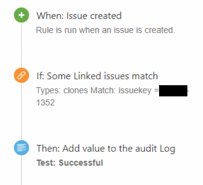

I changed my rule to
When: Issue Created
  Types: clones Match: issuekey = ISSUE-1
Then: Add value to the audit log
  Test: Successful

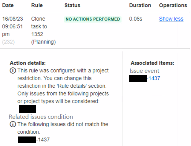

My audit log now says I'm comparing against the newly created issue instead of any linked issues :/
NO ACTIONS PERFORMED
Related issues condition
The following issues did not match the condition:
ISSUE-2
Stefan Salzl
August 16, 2023
So you were in ISSUE-1 and clicked „clone“ and the issue was cloned to ISSUE-2? is that correct?
Could you please share a screenshot of your rule and your audit log?

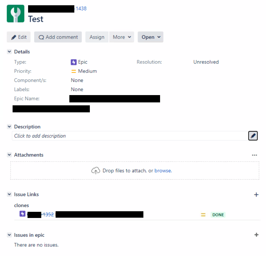

Do you clone the issue within the same project? When you open the clone (newly created issue): is the link set in the issue?
Best
Stefan
Dennis Lindqvist
August 16, 2023
Yes on both questions.
Stefan Salzl
August 16, 2023
could you also send a screenshot of the cloned isseu (the one that triggered the rule): Issue -1437 ?
Dennis Lindqvist
August 17, 2023
I've already removed 1437. Here is 1438 instead :)

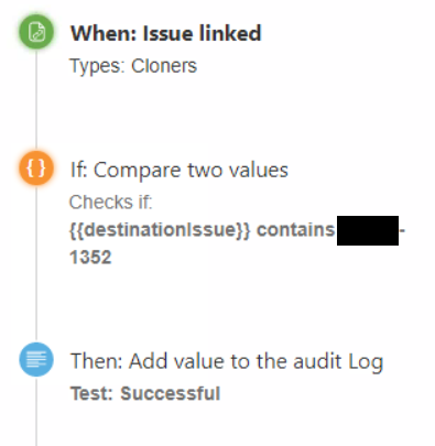

Dennis Lindqvist
August 17, 2023
Apperantly, issuekey is for the newly created issue (duh), and I need to use the smart property {{destinationissue}} (there is no ordinary property available for linked issue that I could find).
See, https://support.atlassian.com/cloud-automation/docs/jira-automation-triggers/#Jiraautomationactions-Cloneissue
So I tried working with Issue linked as a trigger instead...
https://confluence.atlassian.com/automationkb/how-does-jira-automation-issue-linked-trigger-pick-the-source-and-destination-issue-1115133704.html
But I can't activate 'Execute this rule immediately'

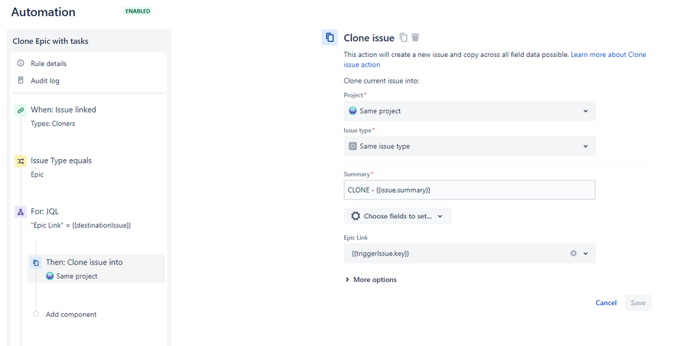

Stefan Salzl
August 22, 2023
Hi @Dennis Lindqvist
So this would be my way of solving it (as far as I got your requirement right now):
This will check for any issues under the original Epic via JQL and then does a "clone issue" for each of the resulting issues also setting the Epic Link to the newly/previously create/cloned epic.
I didn´t do the check if a specific epic was cloned but I guess that was working already on your side. So keep in mind to keep your condition for this.
Hope this helps.
Best
Stefan
Like Dennis Lindqvist likes this
Dennis Lindqvist
August 22, 2023
Excellent help, thanks.
Only issue is; this till will clone all tasks of *any* Epic cloned. I'd only like it to trigger for specific Epics.
Stefan Salzl
August 22, 2023
did you try the rule? if so: could you please share screenshots of your rule and the audit log?
As I created the rule it only clones the tasks of the destinationIssue epic (as it is configured in the JQL). This was also tested in my instance and just cloned the tasks of this specific epic the other epic was cloned from.
