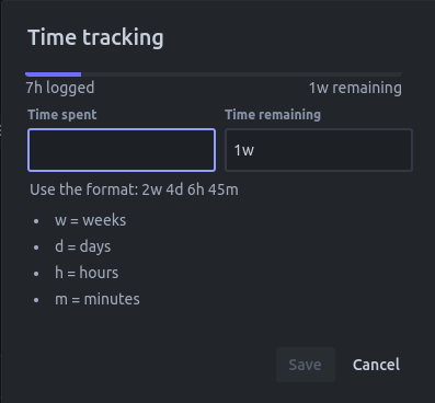

Hello,
I want to block the description field from opening if the entered worklog time is more than the remaining time. Can you suggest a plugin where I can do this?

Muhammed Niyazi ALPAY
February 21, 2023
for example: this issue have a 1 week time. when I enter 2w to time spent field I want to block the description field from opening.
if the employee has spent more than 1 week, he/she should request additional time from his/her manager. As far as I can see, the Scriptrunner plugin triggers the script when the event is completed.
February 20, 2023
I'm trying this plugin, but it doesn't work for what I said.
