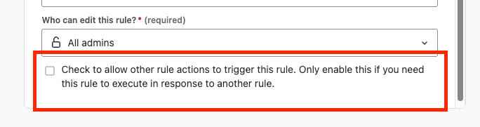

On the Rule Details page is a check box that needs to be checked to allow an Automation Rule to be triggered based on actions taken in another Automation Rule. By default this box is not checked. I suspect that is the root cause of your problem.

That was it! I knew it was going to be something small and silly. Appreciate the help!

By default, the actions of one rule will not trigger other rules.  This prevents mistakes and runaway rule looping.  When you intentionally want a rule to trigger based on the actions of other rules, in the downstream rule, enable this option in the rule details at the top:
Check to allow other rule actions to trigger this rule. Only enable this if you need this rule to execute in response to another rule.
