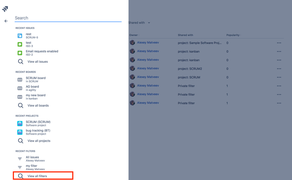

To delete your private filter open the magnifying glass icon and then choose the View all filters option:
Untitled.pngAfter it you will see a list of your filters. You will be able to delete any of them.

Sorry, my JIRA doesn't look much like yours: clicking the main icon shows me a dashboard. I did eventually open the Search action. By scrolling down through all the options, there was a *View all filters* option where you said it would be, but it wasn't on the visible page. It was difficult to find.
I dug around a little more and found a different *View all filters* option on the Issues and Filters tab. Again, it was hidden way down at the bottom where I had to scroll to see it. I was able to bring up the list of all filters, as you mentioned. Clicking on the ... button next to my filter, I was able to activate the Delete option to finally get rid of the bad one.

Updating as of 02/08/2023:
For Jira Cloud, I can delete filters via 2 ways:
1.- Filters > View All Filters > ··· on the right to each filter then Delete (if you are the owner, otherwise you will have to change the owner to yourself then delete).
2.- System > Filters > Manage Filters > ··· on the right to each filter then Delete Filter (if you are the owner, otherwise you will have to change the owner to yourself then delete).
