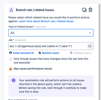

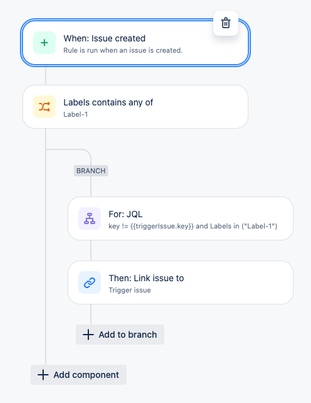

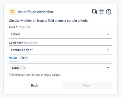

In that case the flow would be:
When Issue Created
And Labels in ("test")
For Related Issues / JQL
JQL: key != {{triggerIssue.key}} and Labels in ("test")

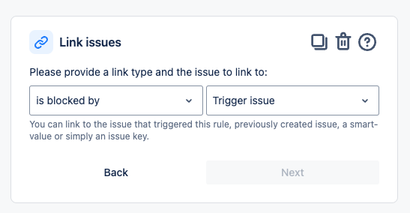

Link issues
link to Trigger Issue

Thank you! The first part is great, but I'm still having a tough time linking every item to one another.
So Task1, task 2, task 3, task4 and task5 are created
task 1 should be linked to t2 t3 t4 t5
task 2 should be linked to t1 t3 t4 t5
task 3 should be linked to t1 t2 t4 t5
task 4 should be linked to t1 t2 t3 t5
task 5 should be linked to t1 t2 t3 t4
Trudy P Claspill
August 6, 2024
Since the rule is run as each issue is created, and if they are created in the order of t1 through t5...
The rule will trigger when t1 is created. There will be no issues to link to at that point.
The rule will trigger when t2 is created. At that point there is only t1 that matches, so t1 will be linked to t2.
The rule will be triggered when t3 is created. At that point t1 and t2 match, so t3 will be linked to each of them.
At this point t1 is linked to t2 and t3. t2 is linked to t1 and t3. t3 is linked to t1 and t2
The rule is triggered when t4 is created. t1, t2, and t3 match, so t4 will be linked to all of them
The rule is triggered when t5 is created. t1, t2, t3, and t4 match, so t5 will be linked to all of them.
In the end after the rule runs for each newly created issue, they will all be linked to each other.

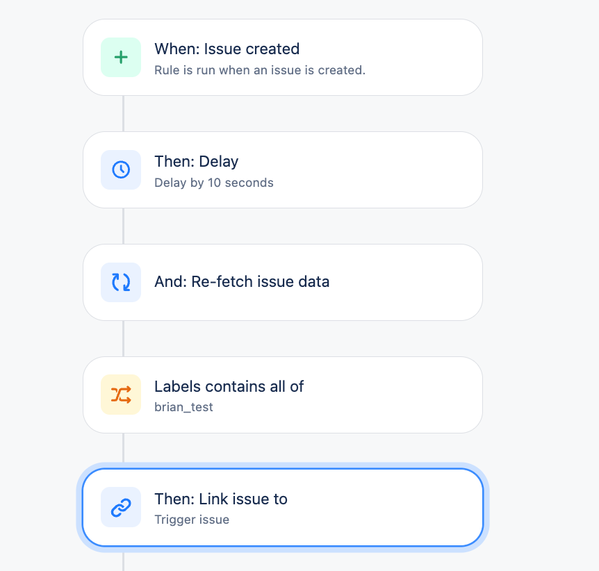

Brian Alves
August 6, 2024
Ahhh I'm not getting that it's only linking to the trigger issue. But I am utilizing another automation to create the tickets, does tha tmake a difference?
Currently I am creating a task
if task is created the create subtasks
subtasks have these labels which is where I need the linking done

Keeping the linking rule as a separate rule should work. However there may end up being timing issues. I recommend that you do a limited run test to see how it works out.
Given that these are subtasks that have the labels you can enhance the rules in some additional ways.
  • After the trigger add a condition to check if the Issue Type is Sub-task.
  • Within the JQL in the Lookup Issues action add conditions:
    • AND issueType in subtaskIssueTypes() and parent = "{{triggerIssue.parent.key}}"

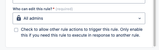

Also, if you keep this as a separate rule there is a checkbox on the Rule Details page that you will have to check to allow the linking rule to be triggered by the creation of issues in another rule.

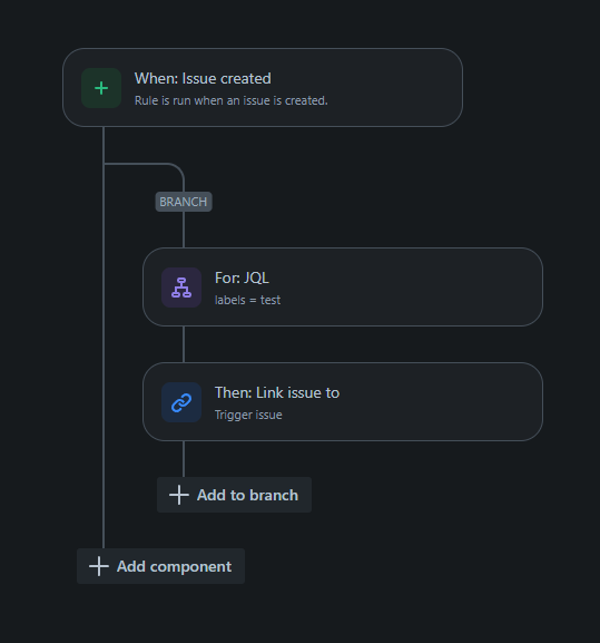

Samuel Gatica _ServiceRocket_
August 5, 2024
Hi @Brian Alves
Welcome to the comunity!
You need to create a new branch to investigate the issue with the same labels, after which you can link the newly created issue with the others.
i.e
Hope this helps!
