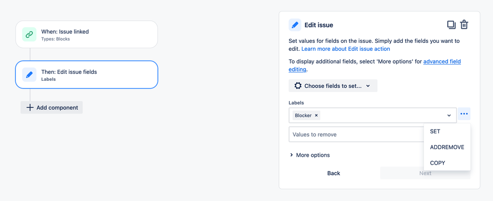

You can create a rule as in the screenshot below
The trigger is "Issue Linked" with type "blocks". The issue that blocks the linked issue is considered the source issue here, so that's the one we need to edit. To add a label, select action as "Edit Issue". In fields to set, choose "Labels". Then click on the 3-dots menu and select ADDREMOVE, and in "Values to add", add "Blocker".

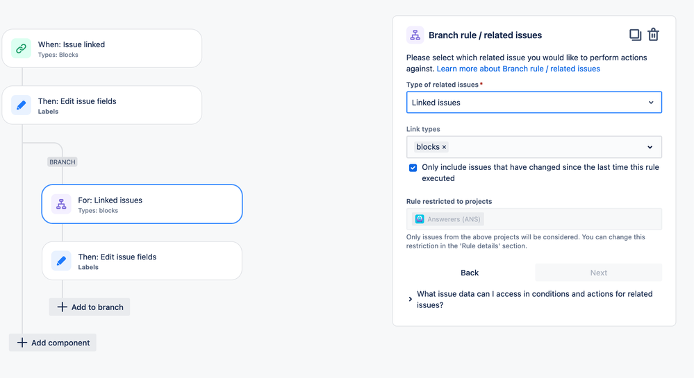

Either direction will trigger the rule. The points to note are:
1. The issue that "blocks" will always be the main issue
2. If you want to add a label on the issue that "is blocked" as well, you can use a branch as in the image below
And then in the next step in the branch, you can add a label (say, "isBlocked") to the issue that is blocked.
