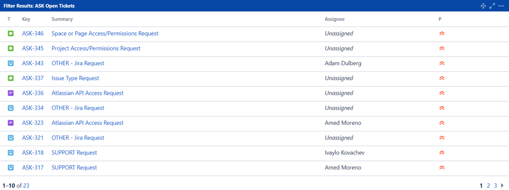

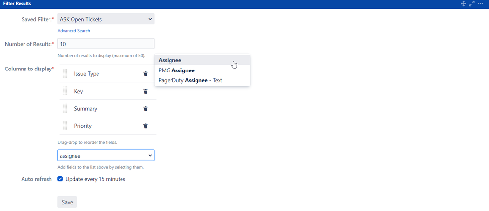

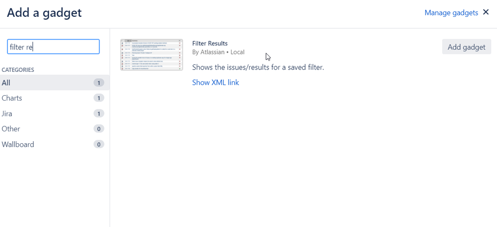

I think for your use case, would be better to create a simple filter that just points to the project (or use the already created one for the project board) and then use the gadget "Filter Results".  Point to the project/board filter (again, the filter should just point to the project, i.e. project = XXX).
After selecting the filter, add the field "Assignee" and you should get what you're looking for.  See screenshots below:
