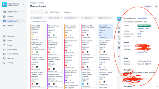

I would like to know how to have custom fields show on the preview screen for an issue.
When you click into an issue card from the Kanban board, a preview shows up on the right hand side of the screen. I would like to know how to configure what fields show here if that is possible.

You can refer to this KB on Configuring the issue detail view. You should be able to add a field when you go to Board > Configuration > Issue detail
If you running in cloud this KB should explain the steps
https://confluence.atlassian.com/jirasoftwarecloud/configuring-the-issue-detail-view-764478043.html

I think I'm having a similar issue as Layna. I want to show my custom field in this side bar preview screen but it's not showing. I have to fully open the ticket to full screen to see my custom field present. I already have the custom field added to the necessary "View", "Create" and "Edit" screens. Please help!

I found a solution to this problem!
on the board in the upper right corner "board" -> "configuration" -> "Issue Detail View"
task preview fields are configured there
