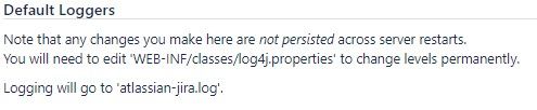

And inside in Jira/Logging and profiling this is shown:
