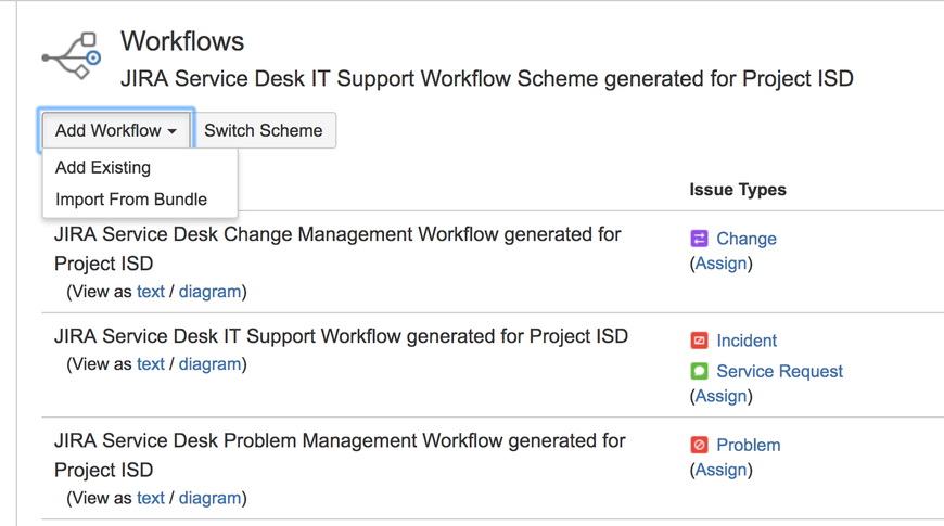

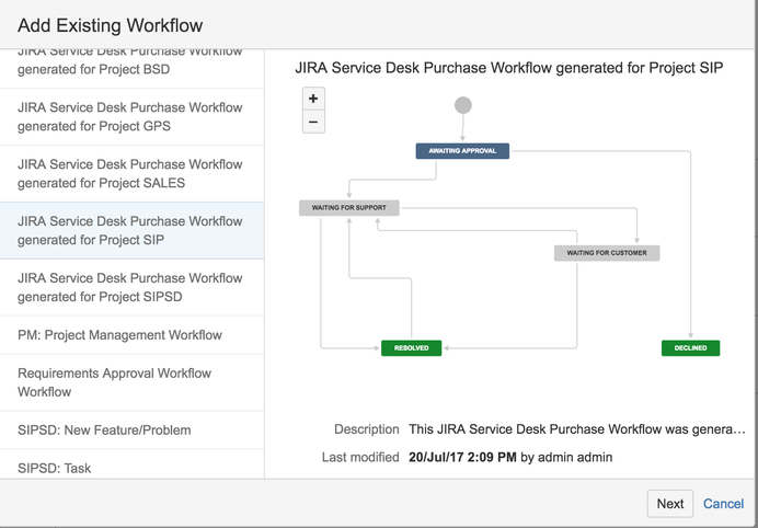

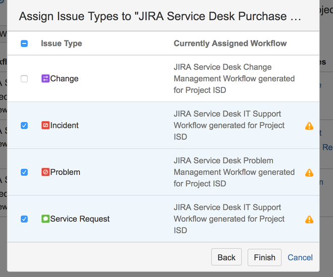

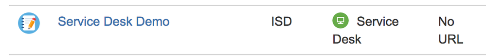

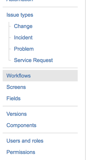

Yes adding the V2 workflow will make the V1 workflow inactive for all the issue types you have selected. Yes the documentation you linked will help you to get what you need. I am going to do screenshots of how to replace see below. I find that going to the project itself is easier to change the workflow. My project is called Service Desk Demo -> Workflows -> Add Workflow -> Add Existing -> Find your workflow, select it then click 'Finish' -> Select the issue types you'd like to change -> Finish.
I hope this helps. It's usually easier for me to visually see something, let me know if this helps! If you need more help, I don't mind assisting you over Skype if you'd like.
