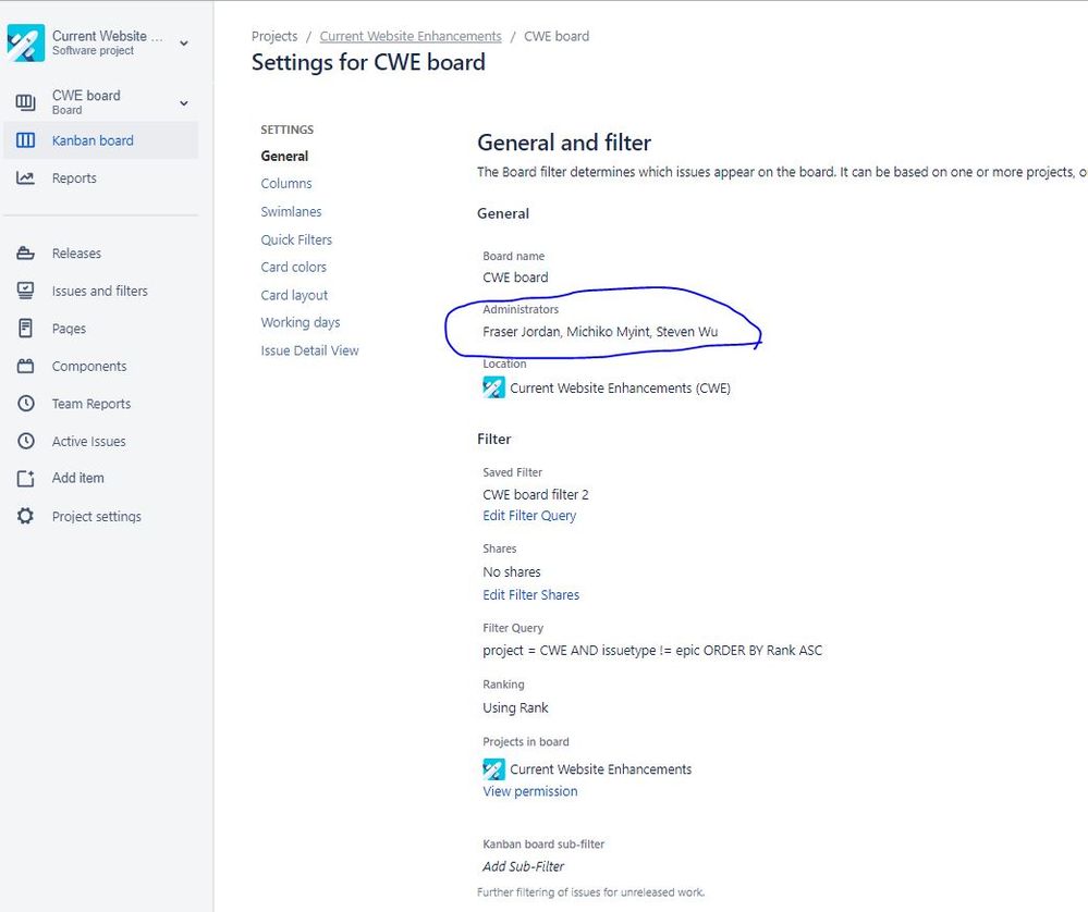

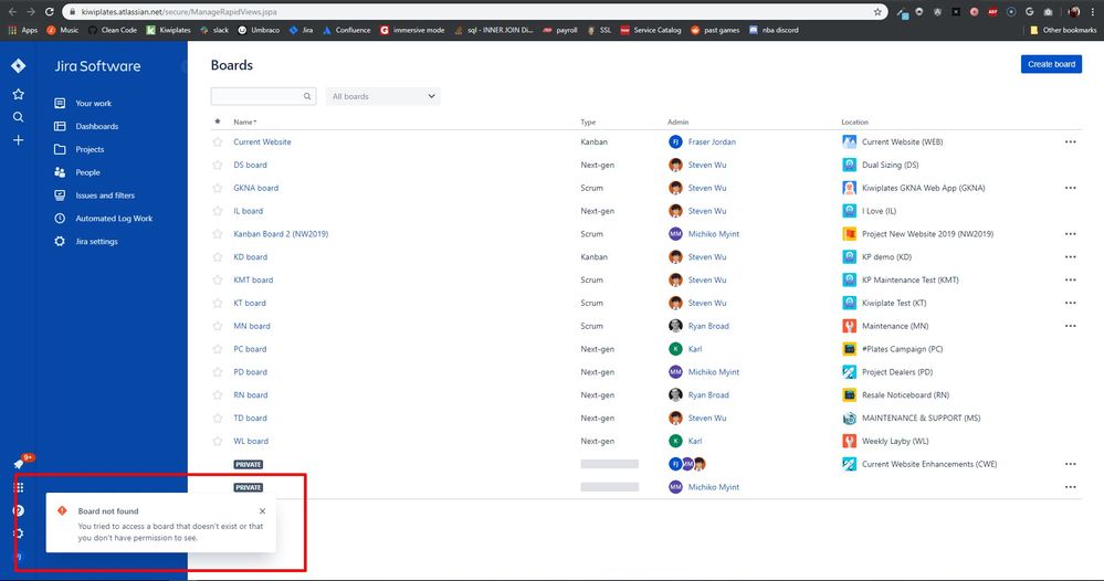

My project is public but for some reason my kanban board under that project is set as private and my team can't view it.
I tried going into the Board settings and even added my team members as administrators but they still can't view it.
both of them can see the individual tasks within the board but they just can't view the board itself.
thanks

Hi @Michiko Myint ,

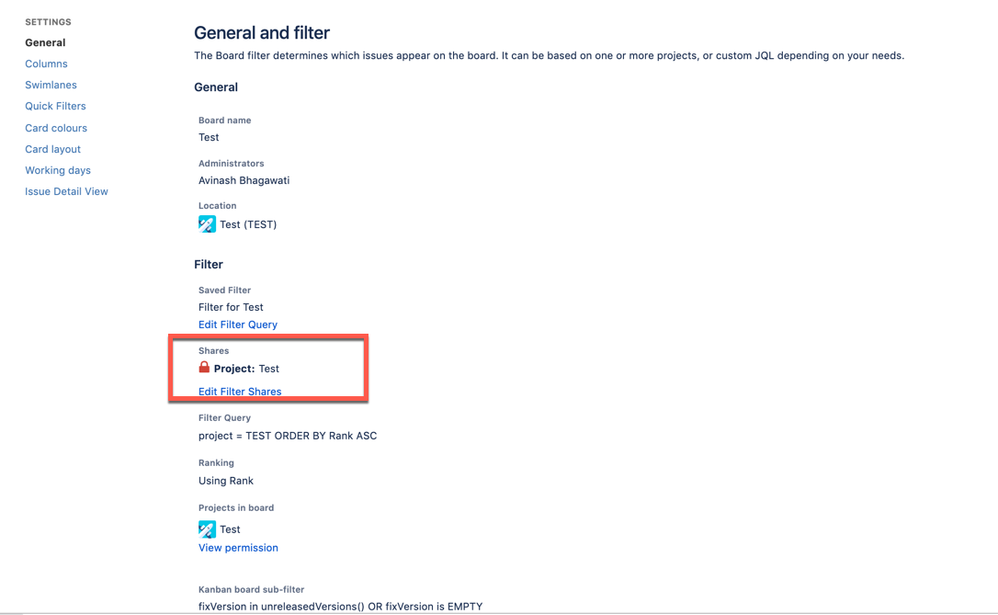

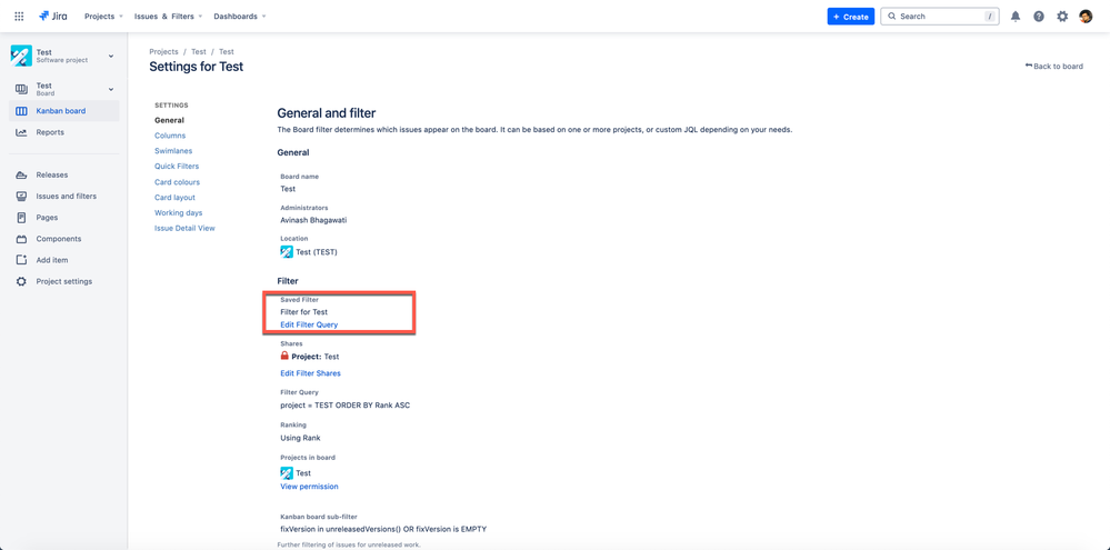

Please note that you need to edit the Edit Filter shares in board and your board filter must be shared with others.

@Avinash Bhagawati {Appfire} sorry that didn't work, I thought i would have. But my team is still seeing the board as private and cannot access it.
thank you for your help but it has not worked unfortunately :-(
November 3, 2019
Hi @Michiko Myint ,
It looks like board filter is not with others, so you need to share your board as well to others.
Please follow below steps.

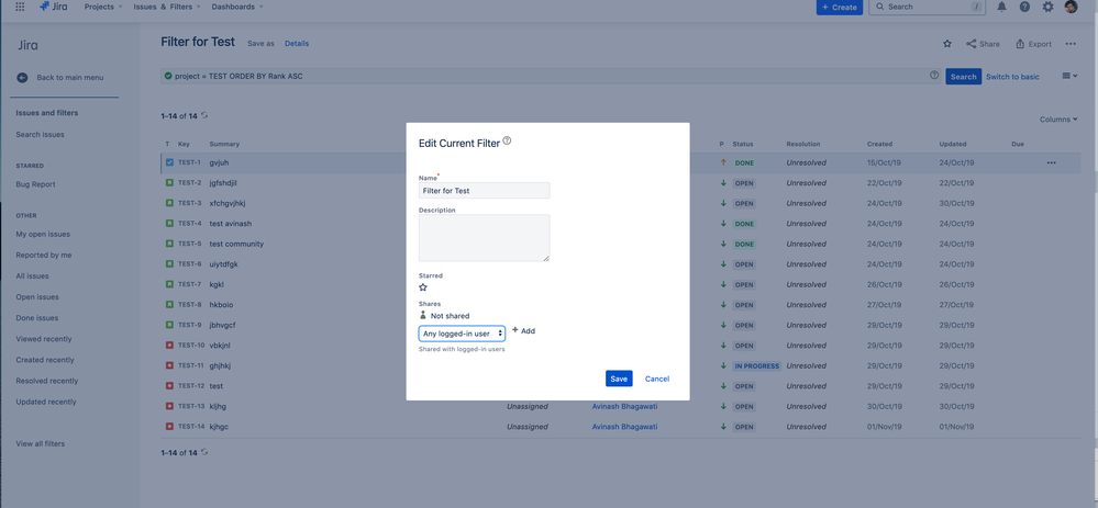

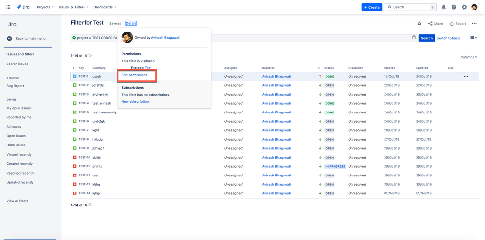

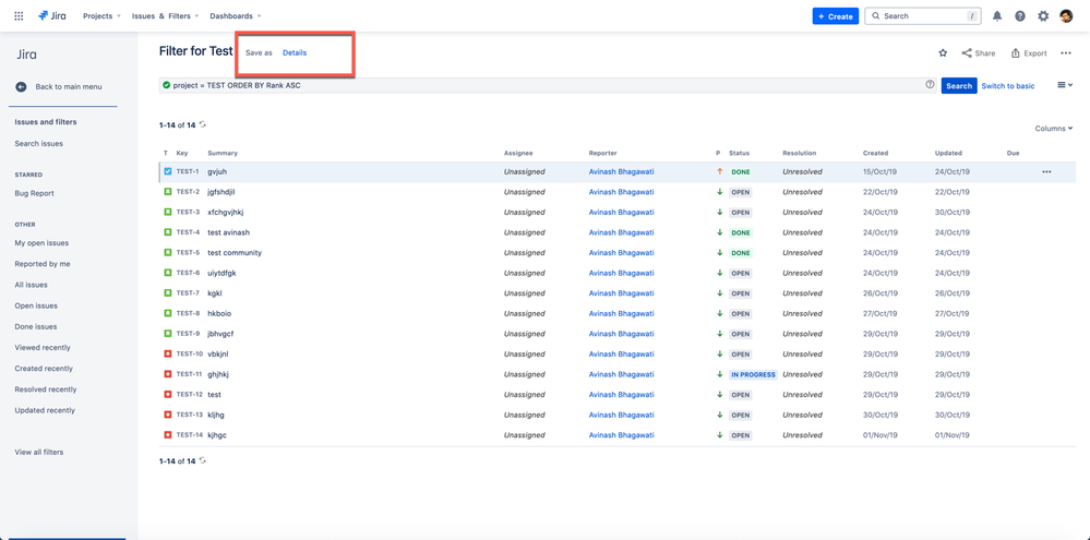

1. Click on Edit Filters
2. Click on Details
3. Check whether it is shared with your group or not. Edit the permissions and add the required to group. If you want to display to all users then select any logged in users.
