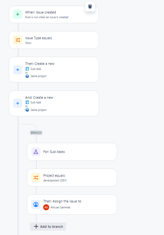

you can try implement something similar to the below through automation and it should work, of course in the branch you can add multiple conditions per project.

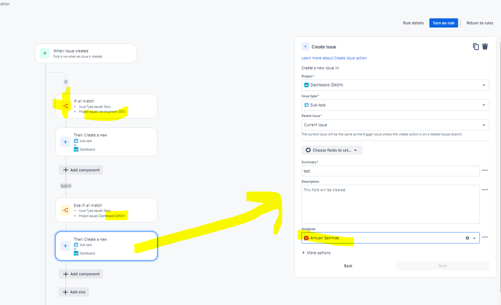

here is the updated rule, you need to use if/else type of condition....first "if" will be project A and type feature then else project B and type feature and so on until I
for each condition the action would be to create a task or subtask (doesnt matter, depends on your case but a subtask would work better so its linked to the feature automatically, otherwise you need to add the feature ticket as Linked ticket to the task one)
also in the step of creating subtask you can set the user according to the condition
