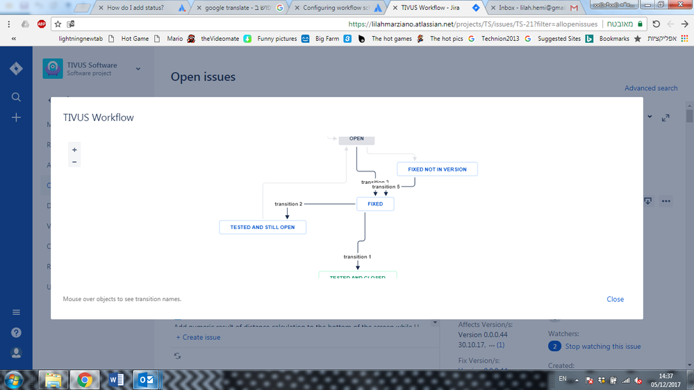

Lilah Marziano
December 5, 2017
Attached is a picture of my workflow. So it is important that I will name the transitions accurately... Can't I define a status for an issue? only transition?
I can see there only two transitionsworkflow.png to pick from, how do I see the rest?
Thank you very much.
Alexey Matveev
December 5, 2017
You name transitions carefully. Transitions handle issue movement from one status for another. For example, in your case Transition 3 moves the issue from Open to Fixed status. You define in transitions from which status to which status the issue must move.
Alexey Matveev
December 5, 2017
I guess your issue is in the Open status. And there are only 2 transitions which go out from the status. I guess these are the two transitions you can see on the screen. If you execute one of the transitions, then your issue will move to another statusand you will see only transitions which go out from the status.

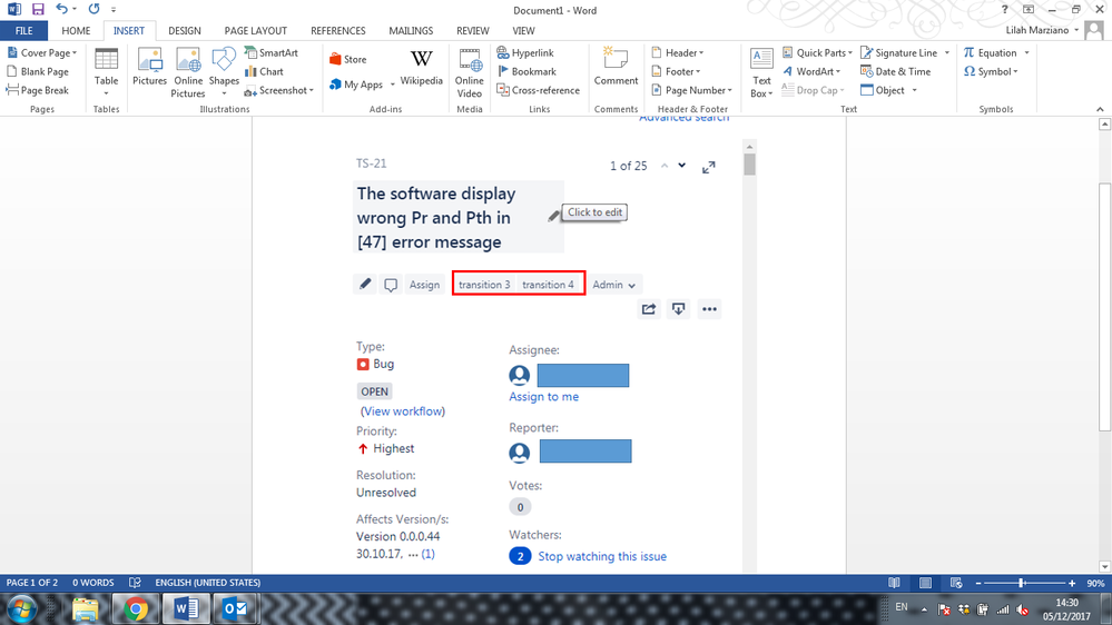

December 5, 2017
Lilah Marziano
December 5, 2017
Hi,
I some how managed to activate the workflow (or the workflow scheme, I got lost there).
And now, in my project I have two problems:
1. For each issue, I want to change the current status to the new statuses I have created but I still can't:(:(, I can only change it to a transition (picture attached), why is that?
2. Everything disappeared from my backlog. why?
Steven F Behnke
December 5, 2017
  1. A transition connects two statuses. Selecting a transition will show the appropriate status.
  2. Go to your board, then click BoardConfigure.
    Make sure that the Columns tab lists your Backlog status appropriately.
