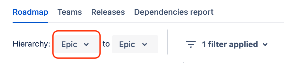

Once the filter is correct for the Roadmap, there are still several things that might prevent you from seeing Epics:
Check that the Hierarchy is set to display Epics. If the first option isn't set to "Epic", then they won't show in the Roadmap display:

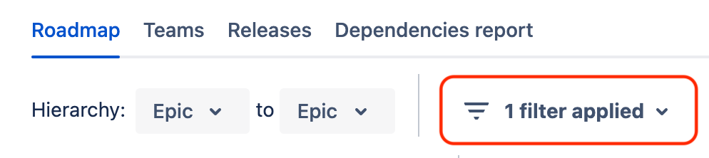

If that doesn't fix it, confirm that you aren't filtering on Issue Types:
Another possibilitity is under "Gear menu > Source data > Exclusion rules", where you can inspect the "Exclude issue types" field.
