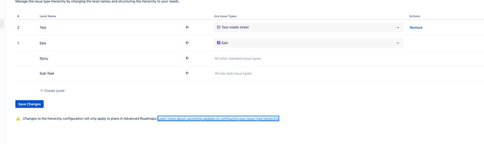

I have Jira premium and I am trying to add another level of standard tickets to be below user stories ( not subtasks).
How does this work? This screen is so confusing. Why can I add level only at the top?

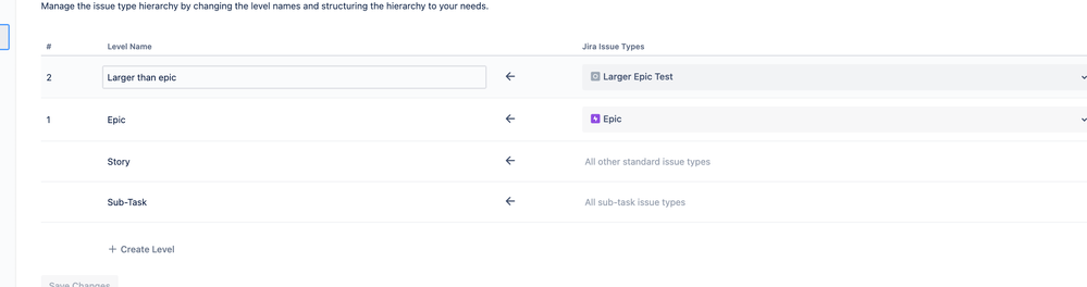

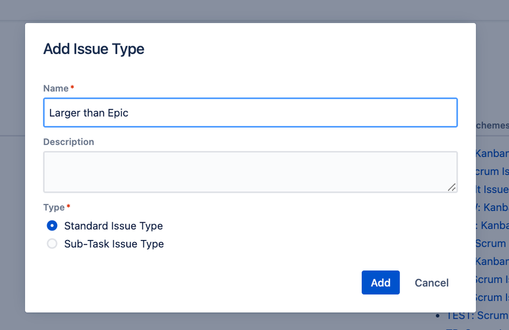

Sorry for the late response. It doesn't seem to work the way you are describing. I tried first to create a new ticket type which was going to be higher than epic:
First issue is that the new ticket type I could create was either standard or sub-ticket type

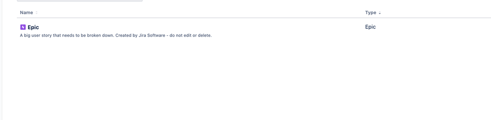

While the epic seems to be of "epic" type (can't create those ones)

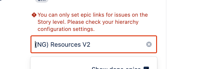

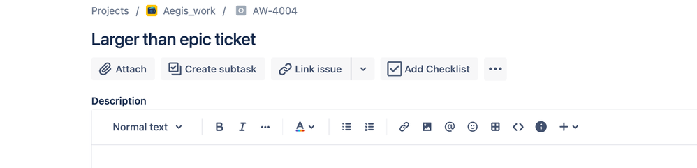

I throught that maybe it doesn't matter and proceded to create a new hirachy with my ticket on top of epics
However when I tried to create an "larger than epic" ticket I could only create subtasks.
It doesn't allow my to have an epic link so I guess "something" got done right.

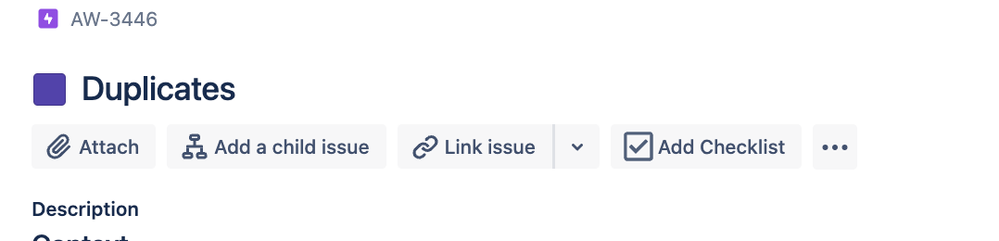

However the behaviour I would expect is to see something like I see for the normal epics the "create child issue" option.

To create a "larger than epic" thing, you need to:
  • Create a new issue type, at the base level ("standard issue type" not a sub-task)
  • Go into the hierarchy and select it to be the layer above Epic
This is, of course, exactly what you have done, and shown us in the screenshots.
The important bit I left out here is that the hierarchy works upwards.  Sub-tasks have a parent issue, recorded with a "sub-task" link in the background.  Standard-level issues have a field for "Epic link" which makes them a part of an Epic.  Epics have a link field that makes them part of the layer above them in the hierarchy.
So, the reason you're getting an error with the Epic link is that your issue is not at the standard level - it's either a sub-task or in the Epic layer or above.  It can't have an epic link if it's not at the story level.

The screen you show us is about the levels in the hierarchy, it is not about the issue types.
Go to admin -> issues -> issue types - you will be able to add new base-issue types and sub-tasks there.   Once you've added the ones you want, go back to the hierarchy screen, and promote some of the base-level types to your Test or Epic levels.
