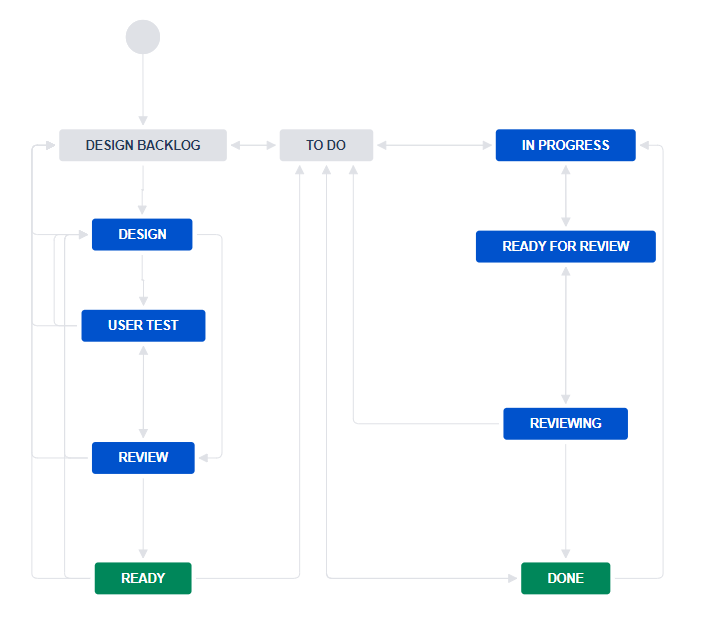

Thanks for drilling into this @John Funk as we have been working towards a newer version and started testing this solution.
We are testing with functionality of a second backlog like function. It all starts with creating in the Design Backlog, after the design is ready for being build we move these to the TO-Do phase where the Build team can pick these up and add them in their sprint when it's time. It looks like this:
John Funk
October 26, 2020
Looks good - we have started using something similar for our upstream/ideation process (your left side) and downstream/execution (your right side)

Indeed the status is included in a board or not. What we are facing is the following. We have a project where we identified a Design and a Build phase.
Cards flow through the Design (Kanban Board), then they return to a backlog where the Build team picks them up in sprints. But not all cards are automatically picked up, they are selected for a specific sprint.
The backlog is shared, but only cards that have been designed can be selected for the Build sprints.
So the question is around how to handle a shared backlog.

Well, I guess I will voice my opinion first, haha. I think it is a terrible idea to move the cards back to the backlog after they have left it and started down their workflow path.
I would think it would be better to have another status such as Ready for Sprint or something like that as it comes out of the Design and is ready.
Otherwise, I would (if you have two boards which it sounds like you do), modify the Sprint board filter to exclude cards that have not been through Design.
It would look something like:
Project = ABC and status was in (Design) order by ASC
