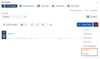

In Xray you have the following two options:
1) Export the Steps in the Test issue:
