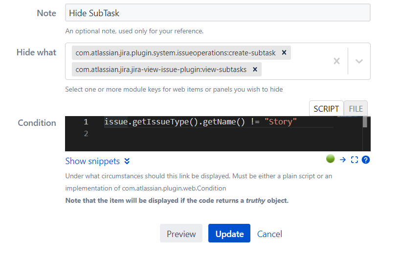

It has to be set as a simple script validator in the sub-task workflow.
You can also add a Script Fragment to hide the sub-task related UI elements.
