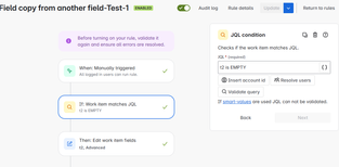

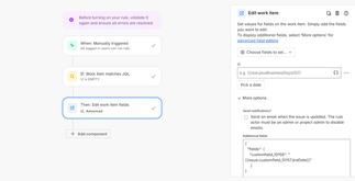

Trudy P Claspill
May 13, 2025
In what way is the rule not working?
What are the results you observe in the issue?
Please provide a screen image that shows the output in the rule audit log for the execution of the rule. Make sure you expand all the sections.
In your automation you are checking a field named "t2"
In your Edit action you're using JSON in the edit action to copy from customfield_10158 to custofmield_10157, and clear the field "t2".
Is one of those two custom fields "t2"?
