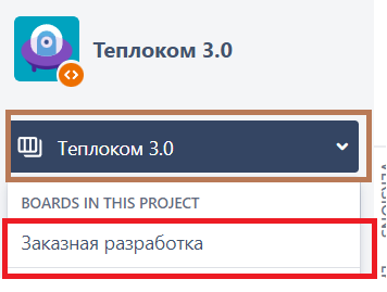

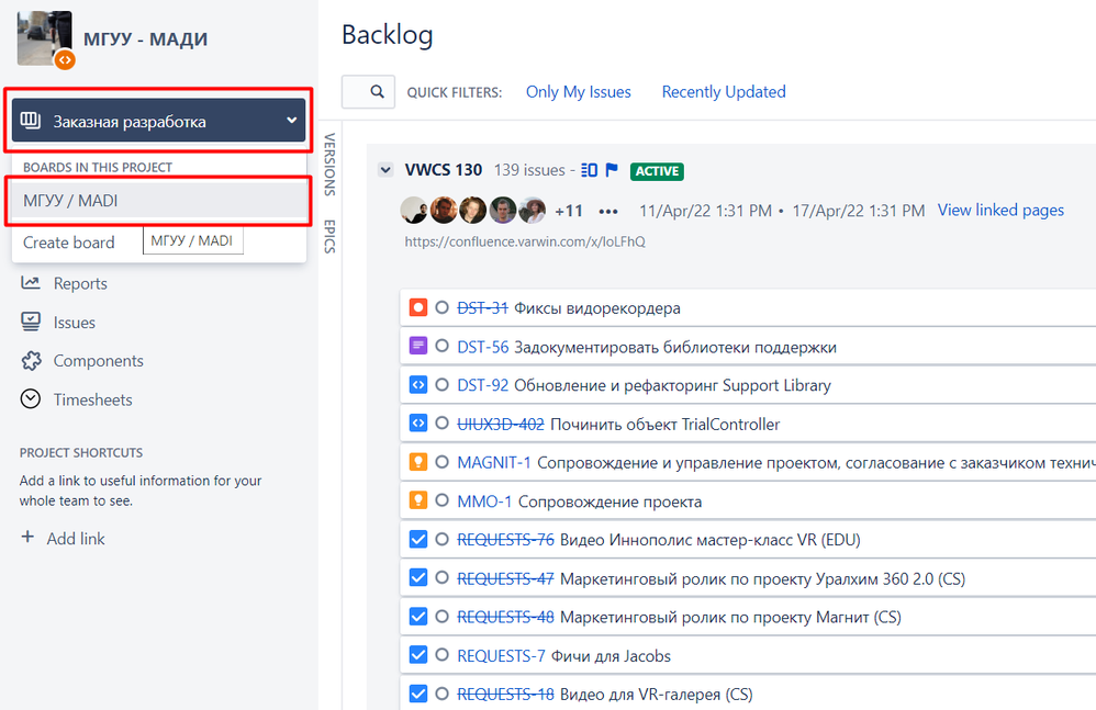

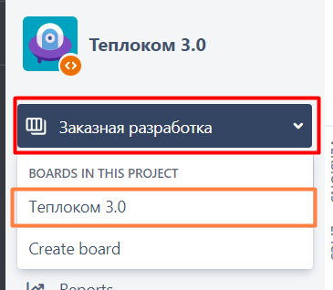

We wanna see in each single project two boards:
1. Board of this project = "МГУУ / MADI"
2. Main board with all tasks with JQL filter = "Заказная разработка"
Three questions:
1. How can i add existing board to new project, without duplicating board?
2. How can i change order in existing single projects, to the project board becomes the first in order? Now we have reverse order.
3. How can i delete second board from the existing project?
Hi,
Filter query for "Заказная разработка"
But i still dont have answers to my questions:
1. How can i add second existing board to existing project, without duplicating board?
To this menu
3. How can i delete second (third, fourth) board from the existing project?
Also in this menu

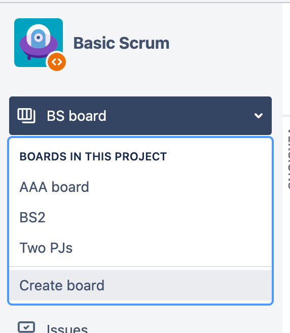

You cannot delete it from the dropdown without removing the board OR removing that project from the Scope of that board.
In the same way you can add more boards to the list by simply clicking the Create board which is the last option in the menu.
@Filipi Lima How can i add existing board to the dropdown? without create a new board?
Hi, Vlad, you can only do that if the project which you are accessing the board from is within the scope of the pre-existing board.
So for example, editing the filter query for that board so that the project is included will make it show in the dropdown but keep in mind issues from that project will get added to the board too.
In summary, that dropdown is not customisable where you can add unrelated board - if the board is relevant to the project then it will show.

The other place you can create board is exactly where you are on the screenshot - you can Create board and it will prompt you for the type of the board and the issue source you want.
Regarding the order of the board on that drop-down from your screenshot, it is ordered alphabetically and it can't be customized in any other fashion.
