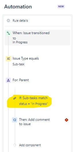

Additional screenshots of my automation rule and Jira board:
This rules works BUT, it's works each time when sub-task moved to status 'In progress'
I need to comment when ALL sub-tasks in the status 'In progress' thats a main case
need to solve.

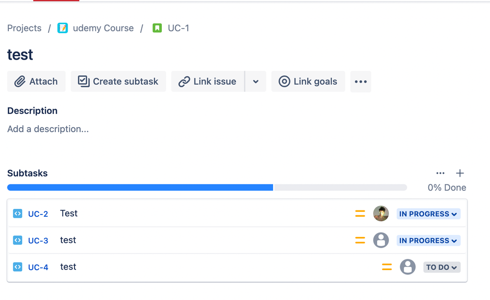

So as you can see i moved not all sub-issue but it's already commenting sub-tasks.
I don't know what filter i need to create or rule to explain Jira when it's need to comment.

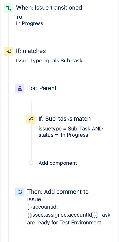

First of all, what are the odds that all the sub-tasks would be in In Progress status at the same time, what if one of sub-tasks moves ahead in the in the workflow beyond In Progress status ? What I am trying to say is the automation that you are trying to create always has odds to fail because of process, unless you have some conditioning going on in the workflow.
Moving on to your automation, there is problem in your automation configuration, it should look like below : The highlighted part uses the related issue condition rather than issue field which checks the condition All match specific jql. And then comment part should be under your if statement & not as separate component like you did which is at same level as branch rule level. This should work out.

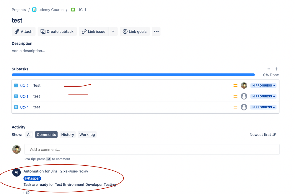

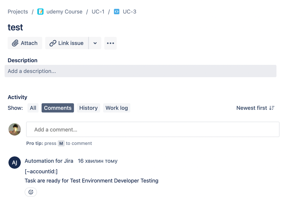

I received a comment that I want only when all sub-tasks in status 'In Progress'
But the problem is I received the comment into Story, not sub-tasks.
Can you help me to receive comments on each sub-task in status 'In progress'?
Thanks!
