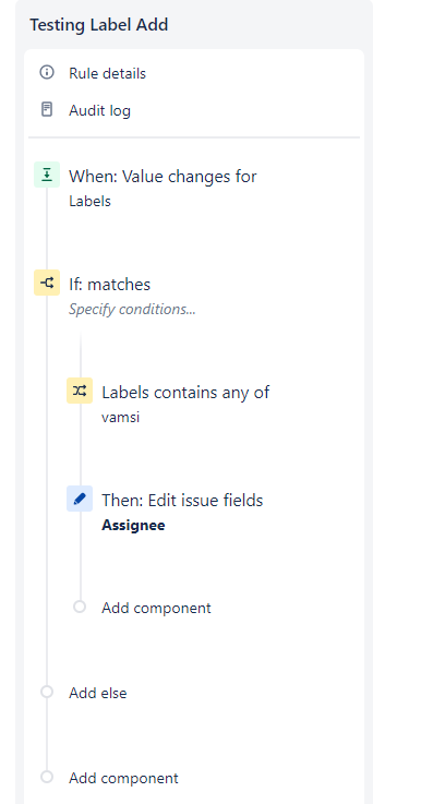

You can create the automation rule as follows.  But, the only catch is that the label which you want to check for, should already be created before you create the automation rule.
  • Select the trigger as 'Field value changed'
    • Select 'Labels' for the 'Fields to monitor the changes'
    • Select 'Value added' for the 'Change type'
    • Select 'Edit issue' for the 'For' field
  • Select component as 'If /else block'
    • Select 'Issue fields condition' component
    • Select 'Labels' for 'Field'
    • Select 'contains any of' for 'Condition'
    • Select the desired label to check for in the 'Value' field
  • Select the appropriate action in the 'New action' depending on your requirement like
    • Edit the issue
    • Transition the issue
    • Assign the issue
Enclosing the screenshot here for your reference.
Hope this helps.

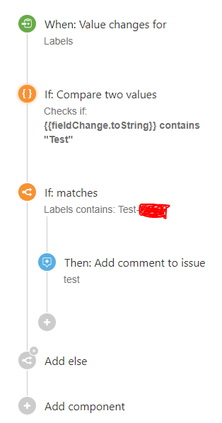

Thanks for your reply! As you can see the automation is pretty simple:
The trigger is "value changes for Label" and after that there is a simple If condition, which checks, if the label has a certain Value (censored, but it contains the word "Test") and based on that, a comment is being created.
Between the Trigger and the condition, i created a new condition, which should check, if the newly added value contains "Test". So if there is any Label, which doesnt contain the word "Test" being added, it doesnt have to run the whole automation. I tried to use the Smartvalue "fieldchange.toString", but in this simple example, the automation stops at this point.
I think this is because the SmartValue is empty.

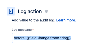

Trudy Claspill
February 16, 2023
Before the "If: Compare two values" component add a Log action to print the smart values to the rule Audit Log.
Add another Log action to print {{fieldChange.toString}}

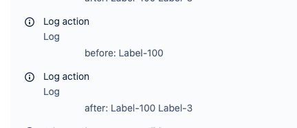

This is the type of output I see when I add another label to the Labels field.

Can you show the details of the new condition that you added?
Note that the new condition you create is not checking if the newly added Label contains "Test". It is checking if any of the Labels contain "Test".
