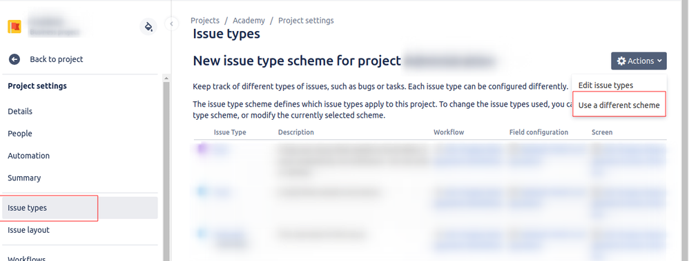

@Antal Dávid At project settings under Issue types check this option perhaps this is what you are looking for? issue.png
