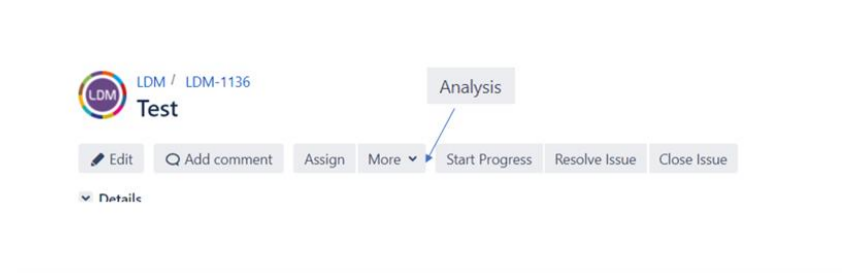

How can i add Analysis(Workflow) button in issue detail

Hi @A412710
Is this Cloud? Looks like Server/Data Center to me.
If it is Server/DC - you can set which Statuses are visible in this bar - but there's a maximum of 3 which can be visualised here.
To do so, you need to modify your Workflow's transition properties. This is managed using a transition property called opsbar-sequence.
So for example, if you have a Workflow with...
  • 5 Statuses (To Do, Ready, In Progress, In Review, Done)
  • Open Transitions (all <> all transitions)
You would...
  1. Edit your Workflow
  2. Select the first transition you want to be on the bar
  3. Choose Properties on the pop-up which appears
  4. Enter the property key as opsbar-sequence, and the property value as 10
  5. Repeat for the second transition, entering opsbar-sequence and 20
  6. Continue down the list of transitions to the end
  7. Publish the Workflow
^ In effect, opsbar-sequence then visualises the transitions in order from lowest > highest number on the screen, with the first 3 being buttons.
I use 10, 20, 30, etc rather than 1, 2, 3 in case I want to move another Status higher in future - then I can just use 15, 25, etc.
There's obviously a lot more options with a closed Workflow (no all <> all transitions).
If you'd like more specific instructions on how to do this - please provide a screenshot of your Workflow :)
Ste

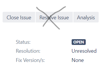

Hello @Ste Wright
thank you for the useful info, how can I display the button "Start Progress" instead of the button "Resolve Issue"?MicrosoftTeams-image (5).png

Hi @A412710
Assuming Start Progress is a possible transition from the Status "Open", and you don't want to remove the Resolve Issue transition - you should...
  • Identify all the outwards transitions from this Status in the Workflow (i.e all the outward-facing arrows going to other Statuses).
    • This could be all transitions, if the transitions are all <> all
  • Open the Transition Properties for all of these
  • Set opsbar-sequence as follows...
    • Close Issue - opsbar-sequence = 10
    • Start Progress - opsbar-sequence = 20
    • Analysis - opsbar-sequence = 30
    • Resolve Issue - opsbar-sequence = 40
This would put Start Progress as the second button. It would also make Resolve Issue fourth - placing it in the "Workflow" list.
Let us know if this works!
If it doesn't, a screenshot of your Workflow might be beneficial here, and any additional information about the need.
Then we can advise further on opsbar-sequence - or, if there's another reason it's not working as expected.
Ste
