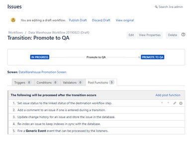

I am an admin.  I clicked the Transition.  Below is what I see.  I'm not sure if the edit/delete icons to the right of the list are grayed out because I'm in a Draft copy or because my co-admin has locked this project down (which is fine - she can update it if need be).
Since the instructions for Resolution Set Using a POST Function state to Click 'Add POST Function > Select 'Update Issue Field', I guess I would have thought one of these in the list would have been for a post function of Update Issue Field'.  Is this where I'm supposed to edit?
Nic Brough -Adaptavist-
December 26, 2019
Yes, you'll find those icons are click-able.  The permissions are not that fine-grained, if the icons appear, you have edit rights.
However, you don't need to.  There is no post-function setting the resolution.
I suspect the screen for the transition has the resolution on it.  That will set the resolution as well.

I think you are correct.  When I change the status to Promote to QA, a Promote to QA screen pops up and Fixed is the default resolution.  Now I need to try to remember where/how to configure/fix that.
