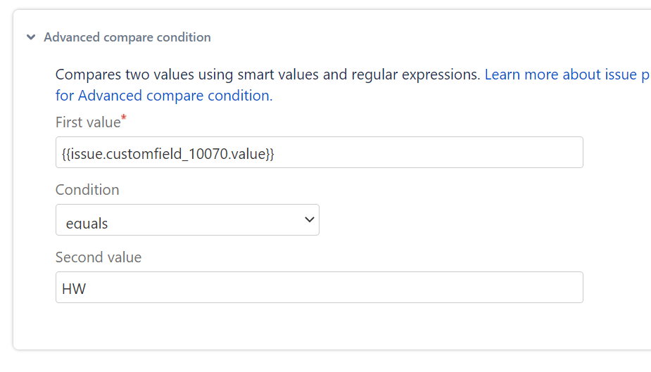

Hi @Laura Bennett ,

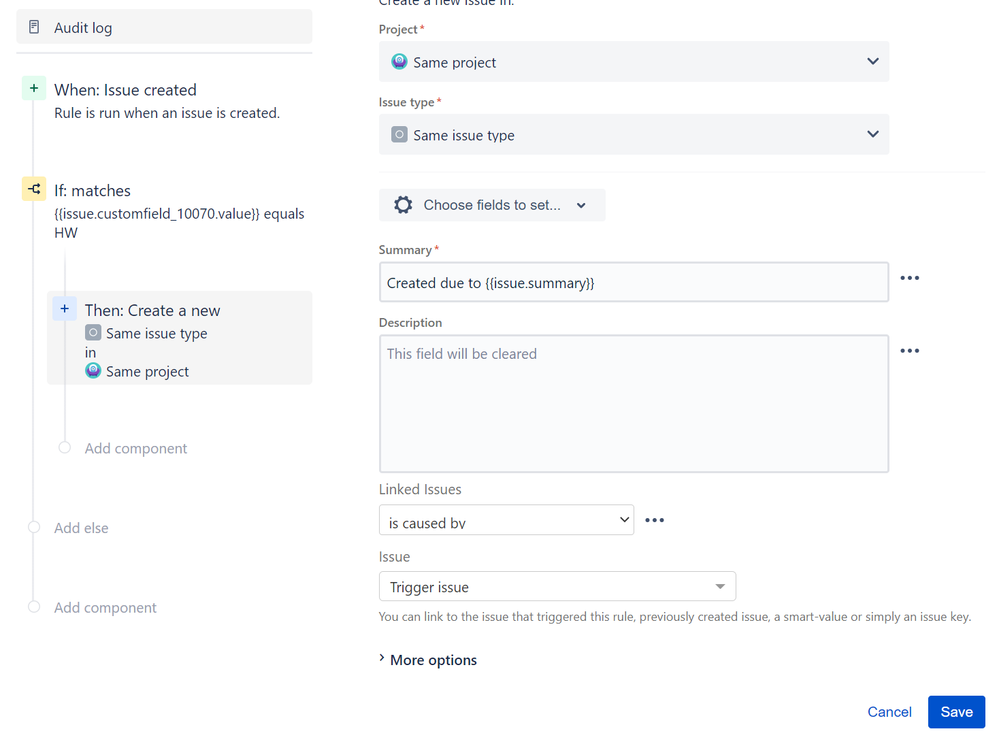

You will need to use the Advanced Compare condition as seen here. Just replace the custom field ID with the ID o your custom field. This finds the value of the parent cascading option - if you want the value of the child, then you will need to use {{issue.customfield_id.child.value}}compare.PNG
This covers the parent condition part. To set up the rest of the rule, you will use the Create Issues action, and under the 'Choose fields to edit', you will select Linked Issues, then choose the issue type and make sure the created task is being linked to the Triggering issue
