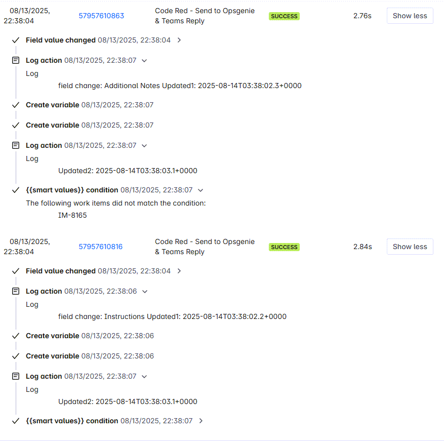

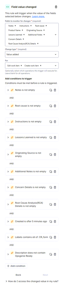

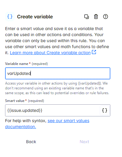

Multiple fields updates (preformed by other automations) can trigger this automation, and when all the fields are filled out, the automation conditions are met and trigger succeeds. Occasionally, this automation is triggered twice in quick succession. To address this, I implemented a process where the automation promptly updates a specific field and added a condition to the rule requiring that the field not contain this. However, because the triggers occur only 0.1 seconds apart, the subsequent execution does not detect the update. Any suggestions to prevent this? I believe the problem is with the trigger, because the previous automations occasionally end at the exact same time. The previous automations are triggered by a form being submitted.
Trigger and trigger conditions

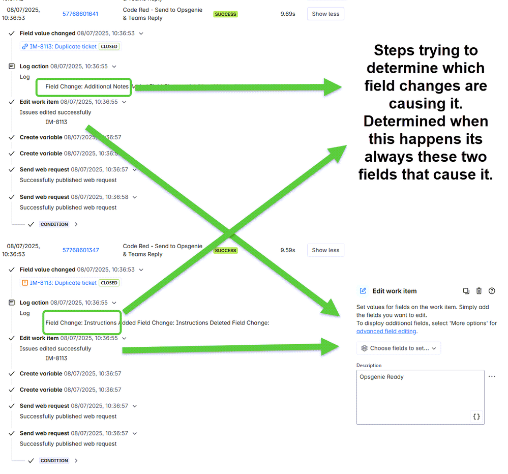

Updating the Description audit log and determining which field updates cause the problem2025-08-14_09-32-34.png

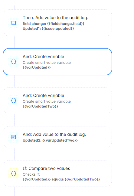

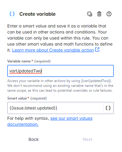

Attempted to add a check with the last update, this caused the automation to just not complete in these instances
2025-08-14_09-33-35.png2025-08-14_16-35-46.png2025-08-14_16-36-02.png2025-08-14_09-34-42.png

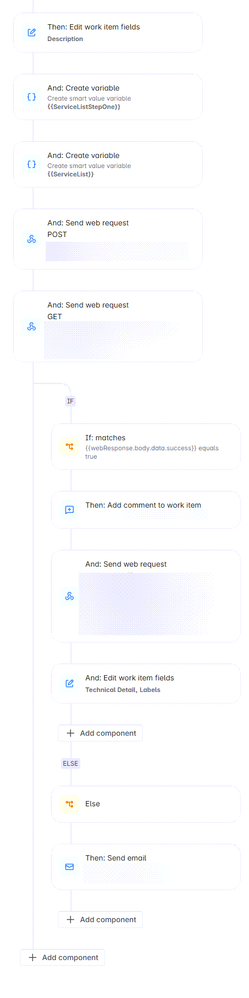

The rest of the rule

In this case, if I am understanding correctly without being able to see the rule, try adding a Re-fetch action immediately after the trigger (which I assume is a Field Value Changed trigger). Then be sure there is a check/Condition making sure that at least one of the fields is empty.

Okay, this might be as simple as adding a Re-fetch action right after the trigger. Or even a Delay action, maybe for 3-5 seconds, but let's see if the Re-fetch does the trick.
The 2 causing the problem most often are probably Paragraph type fields which are bigger and got more going on with them. But, again, hopefully the Re-fetch works.

I tried a re-fetch. I tried a delay. None of it ended up preventing it. What I ended up doing was making it so the field that *typically* is the last to complete is the only one that can trigger it. I then check that all the other fields aren't blank. If any of them are, it does a re-fetch, which gives the other automations enough time to complete. So far this seems to have worked.
