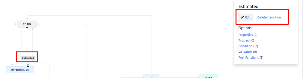

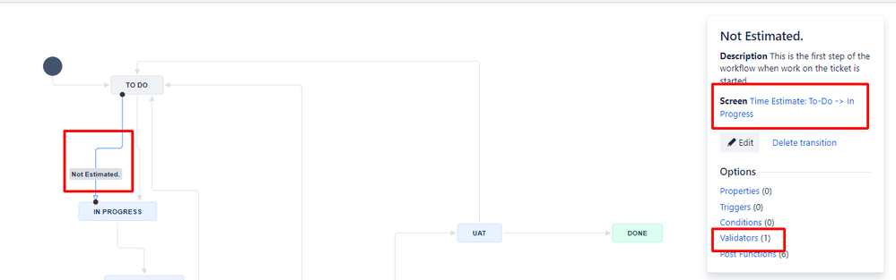

@Sudarsana G - Thank you for sharing your answer. I think this is what I'm doing. Please see the screenshots. @John Funk
I have covered all the details. Please check and let me know how this will be done. Thank you in advance.

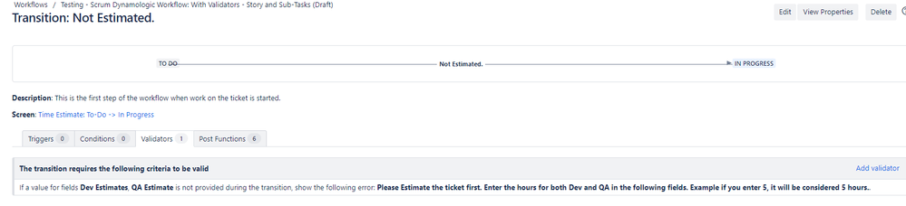

Case 1: Screen with Validator when fields are not estimated. This is working fine.

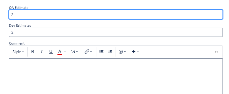

Case 2: When Fields are already entered then I don't want the pop up to show:
Why this is showing to me when my fields are already estimated.

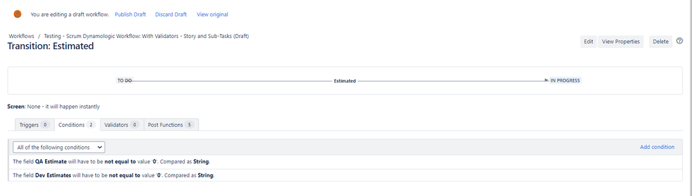

Conditions:

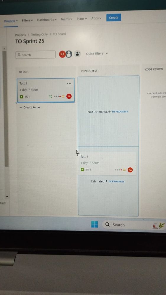

What does exactly mean screen pop Is that "Transition Screen" ? Transition screen will appear only if you have added In the above screen its showing two transition's Estimated and non estimated if you have added proper conditions for both the transitions it will not display both the transitions only one should display  you have to add condition for Estimated also
Please note based on the conditions only one transition has display if no values non estimate if the existing values  Estimate transition has to be displayed So set the conditions for both the transitions accordingly

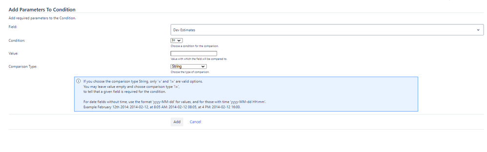

@Sudarsana G - Thank you for your help so far. Can you please let me know which conditions I will be using. In case of non-estimated the fields will be empty. What would be the condition for that and vice versa. Please.

Yes Compare Parameters condition will help if estimate=0 or null non estimated if Estimate is greater than 1 or more the Estimate

Right now, I have added a validator from To-Do to In Progress transition and attached the screen with pops-up if the estimates fields are not entered.
