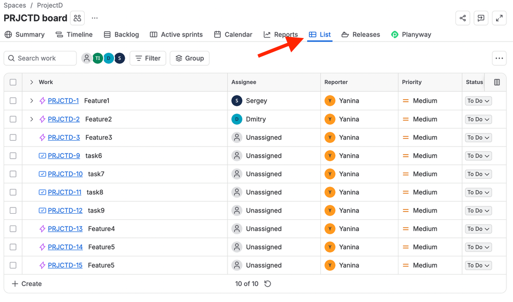

Hi @Kim Wright
As many have pointed out, you can get that view in the List tab.
However, if your goal is to report on delivery work from Epic down to Sub-task level across multiple Jira projects, you may need a view that combines hierarchy with execution details.

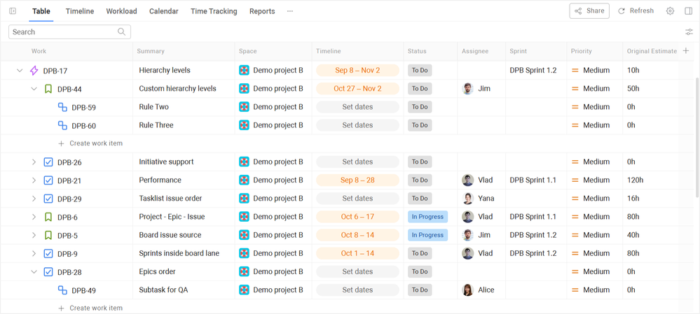

If that's the case, you may want to take a look at Planyway Table. It keeps the Jira hierarchy visible instead of showing everything as a flat list, so you can expand an Epic and see the related tasks and sub-tasks underneath.
With Planyway Table, you can see and report on:
  • who is assigned to each item
  • estimates and deadlines
  • what is completed and what is still in progress
  • how work is distributed across projects
Plus, it can save you from exporting Jira data and manually rebuilding the hierarchy in spreadsheets just to get a clear view of project progress.

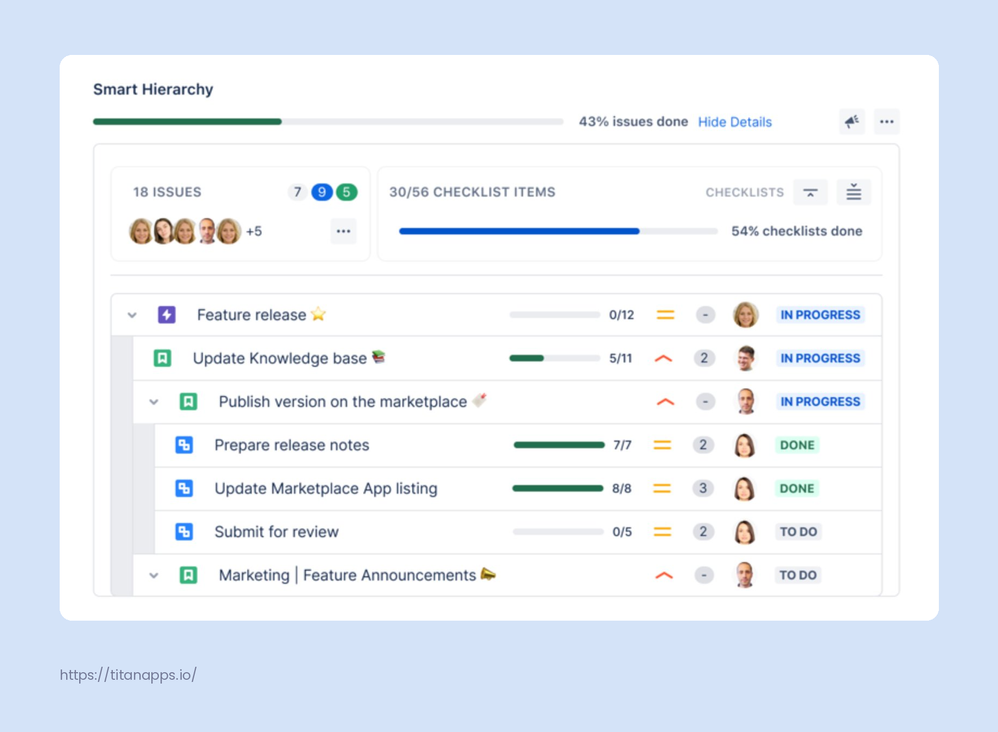

On our side, we approached this from a different angle. Our solution, Smart Hierarchy for Jira, adds a panel inside the work item view. You can open any work item and you will see the whole tree above and below it.
For Epic-to-sub-task reporting, the panel gives you:
  • Rolled up completion percentage across the hierarchy
  • Total number of work items with their assignees
  • Story points split by status, like To Do, In Progress, and Done
  • Aggregated checklist progress, if your team uses Smart Checklist
Here is what that looks like:
The app is free, and it renders up to 50 work items per level. It starts from a work item rather than a saved filter, so it fits well when you want progress per Epic.

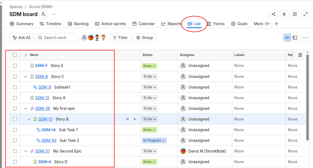

Hi @Kim Wright,
The Jira search results screen does not show the issues hierarchically.
You can get a hierarchical view in the List tab of the spaces/project.

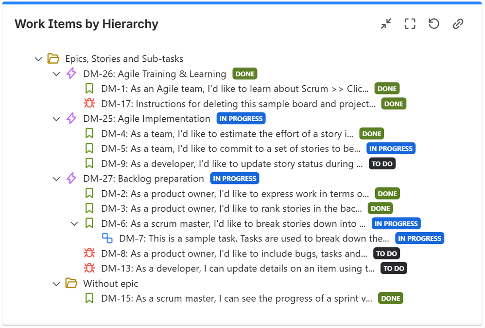

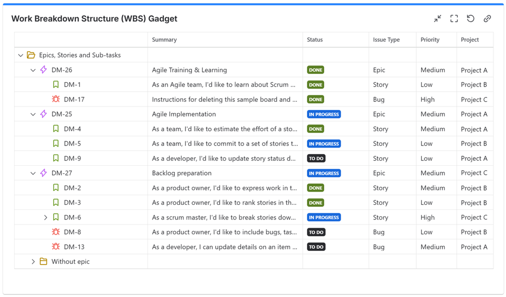

Another solution would be to use a plugin from Atlassian Marketplace. In case you want to use a plugin, our Great Gadgets app offers a Work Breakdown Structure (WBS) gadget that is capable to display the issues hierarchically, in form of Initiatives > Epics > Stories > Subtasks, as a tree view or as a hierarchical list.
All you have to do is to configure it will a filter that returns the issues to be displayed, and it does the hierarchical grouping for you.

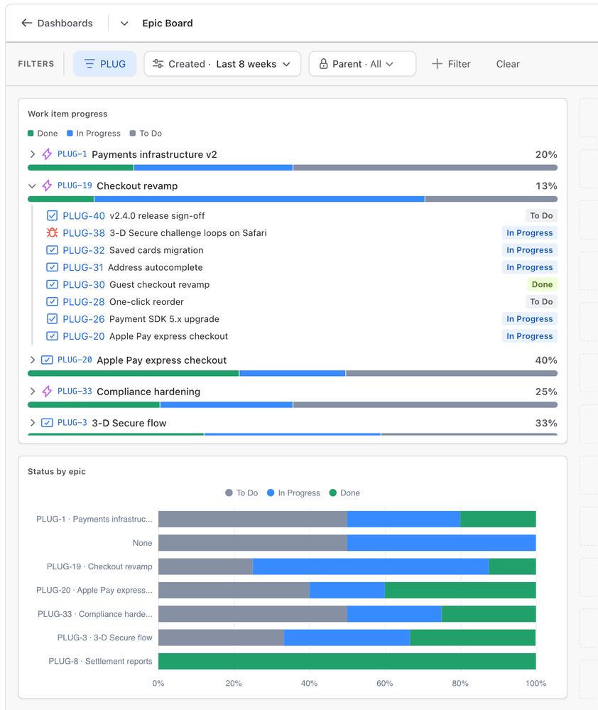

  3. Marketplace apps — full disclosure, I'm the developer of Plugio Suite: its "Work item progress" widget gives you hierarchy-aware reporting without any JQL: each parent gets a progress bar rolled up from its direct children — epics from their stories, and stories from their subtasks — and expanding a row shows the individual child issues with their statuses. You can scope it by project, filter by a specific epic, restrict it to a time window or the active sprint, and combine it with other widgets (pivot tables, charts, counters) on the same dashboard. Here's what it looks like:
