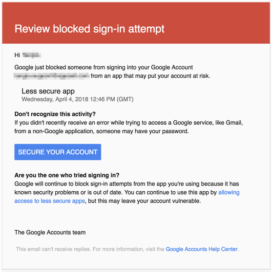

Have you already enable the Less Secure Apps in the Gmail account? This is usually a common issue with Gmail and Jira.
https://support.google.com/accounts/answer/6010255
Once logged in to gmail with account, go to this URL to make the change of that setting.
https://myaccount.google.com/lesssecureapps?pli=1
I hope this helps and if it doesn't, let us know.

In my experience, yes. I know that gmail also allows application specific passwords but I’ve never tried that with Jira. I would test turning off that setting to test. This will at least confirm that’s the issue.
