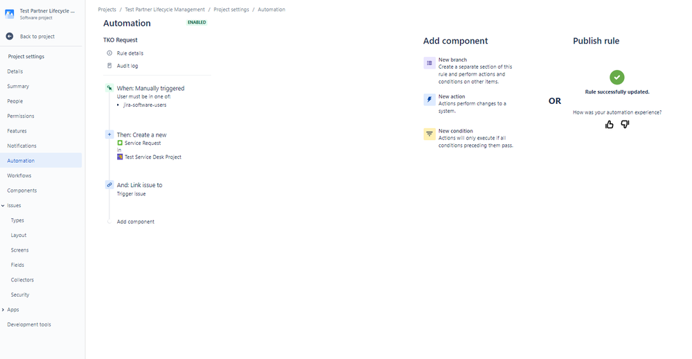

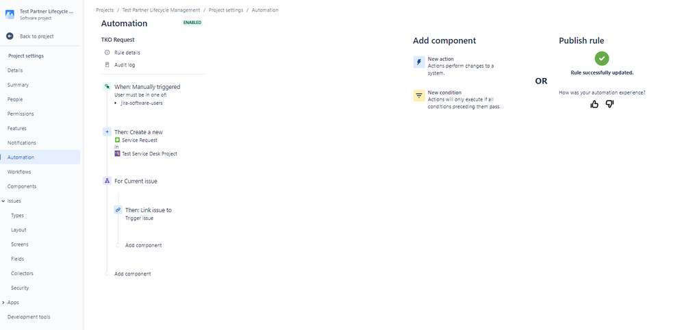

Hi there - looking for some guidance on how to set up a multi-step automation rule for a couple different scenarios in Jira Cloud. I tried to follow the automation guidelines in the Atlassian documentation but I can't seem to make it work.
1. When a ticket is created in a software project, upon manual trigger, a new ticket will be created in a service project AND the 2 tickets will be linked together using the "relates to" link type. (I have attached the 2 different ways I tried to accomplish this as screenshots)

Hi @Kyra Mayock -- Welcome to the Atlassian Community!
FYI that for the rule images you posted, one does what you describe and the other (with branch on Current Issue) seems to try to link to back to itself.
For your question #2, that would be possible to trigger the rule on the status/comments in the software project issue to update the linked one.  You would branch to the linked issue to make the updates from the trigger issue.  Please note: This would need to be a global/multi-project scope rule, and depending upon your license level could be impacted by monthly rule execution limits.  Please discuss this with your site admin to learn about such limits.

Kyra Mayock
April 26, 2022
Hi Bill!
Thanks for replying. I thought my first screenshot, without the branch, should accomplish what I wanted too. However, it doesn't seem to do anything when the rule is run :(
For Scenario #2 - Do you happen to know the steps to make your suggestion work? Since I'm having trouble even linking newly auto created tickets, I don't think I'll be able to set the rules properly to execute these functions.

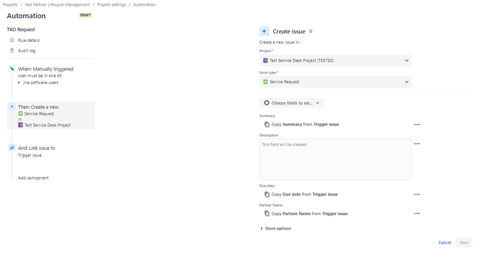

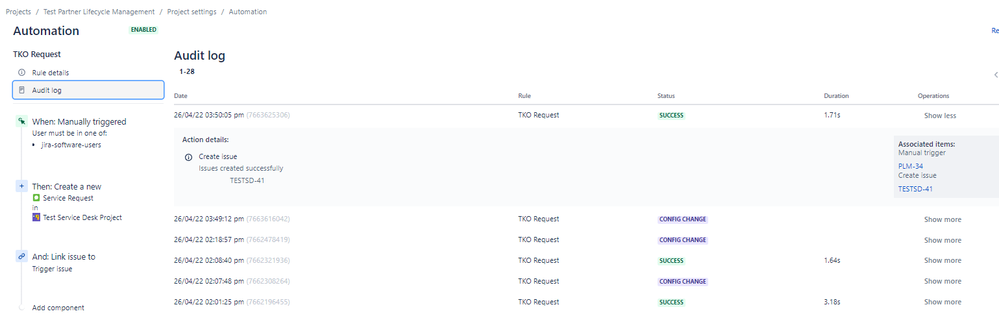

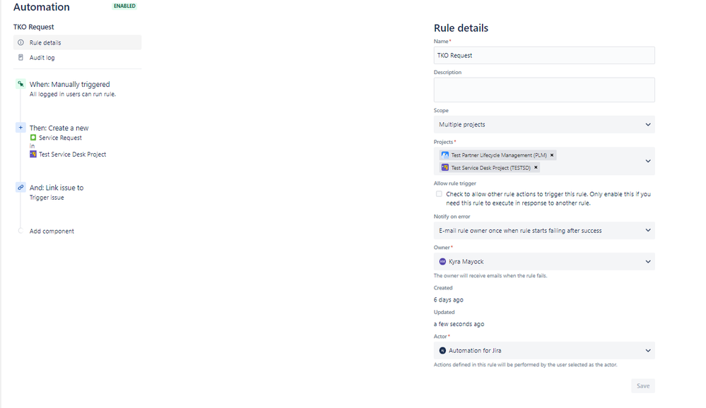

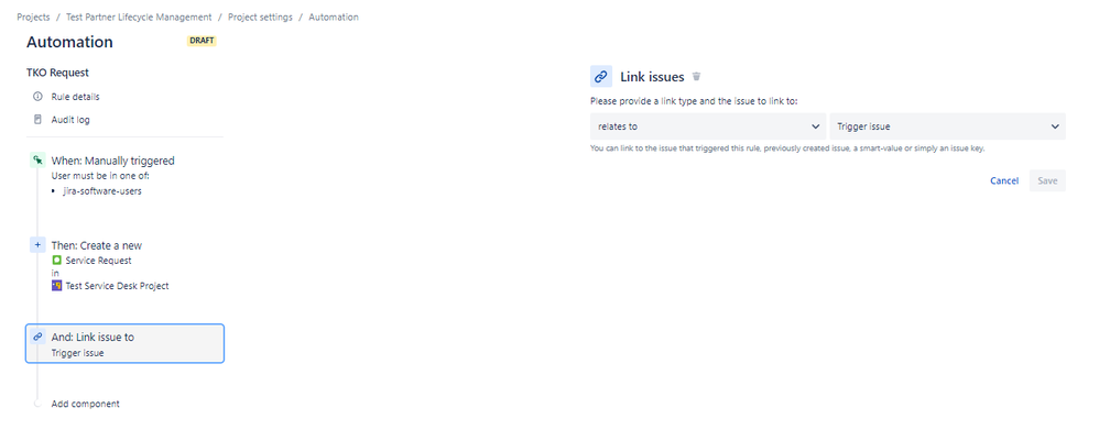

Can you please show the details of your rule's edit and link components, and and image of the audit log details showing what happens when the rule runs?
I know that "clone" cannot link issues in one automation step, but I thought the Issue Create action could do so.  Perhaps this rule also needs multi-project scope.
Kyra Mayock
April 26, 2022
Kyra Mayock
April 26, 2022
The log says the rule runs successfully, and it does indeed create the new ticket - it just ignores the Link part.

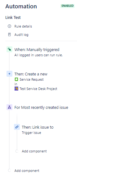

Kyra Mayock
April 26, 2022
I actually think I figured it out - I had to add the action of create rule, then create a branch and select "most recently created" then add the action of Link Issue!

Bill Sheboy
April 27, 2022
Well done!  That is what I thought was happening with the missing branch to the created issue.
