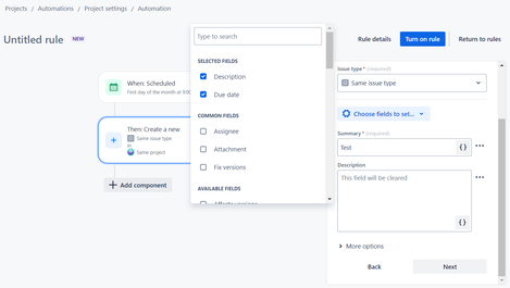

Hi @Kara Nadarajah I believe you have a scheduled trigger that creates an issue on the first day of every month. To the action that creates the issue, you need to set the value for the due date field. You need to choose the due date field from the options. Under the Due Date field, click on pick a date and set the value. Hope this helps.Automation - Set Due Date.png
