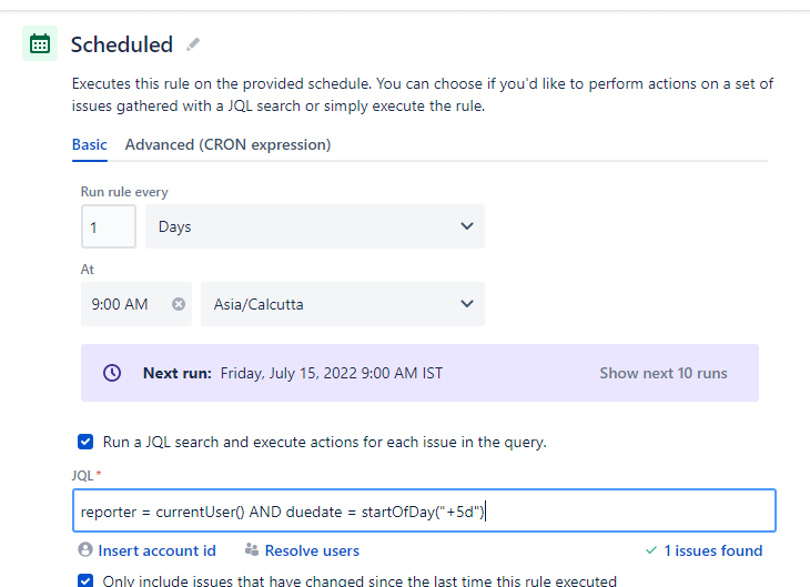

2) you can use automation , as shown below. with this method reporter will get mail for one request.

Hi @Sreenivasaraju P I tried applying an automation and it worked for me, I was putting wrong condition previously. Thank you for your help!

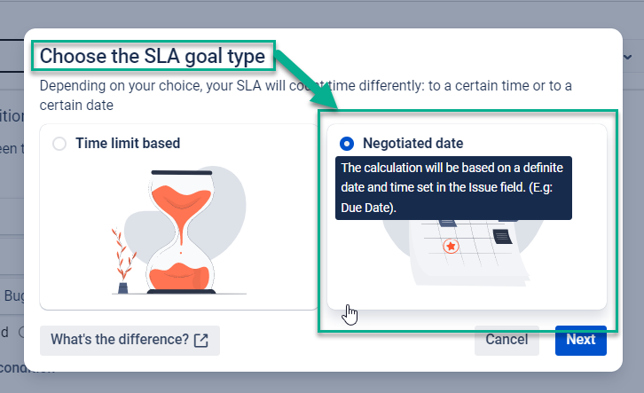

If you need to get such “reminders” on the day of the deadline and also a few days before. I can suggest you to try SLA Time and Report for Jira add-on. There you can set up sending such notifications as many times before the deadlines as you need.

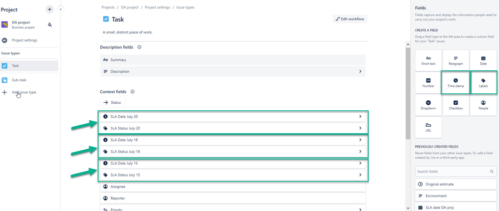

For this, you just need to add Custom Fields to the Issue with the dates when you want to get the reminders that the task needs to be done and labels with statuses. Here is how to do this in the Project settings (for example, in Next Gen project):

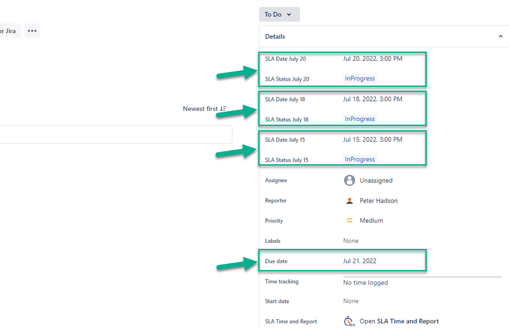

After that, define in the Jira issue the exact time when you want to get the reminders:

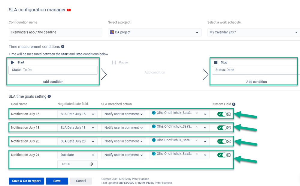

Go to the SLA Configurations Manager and set the conditions according to which you will get the notifications. Choose when you want to get the reminders, a person who will get them. The settings should be like this:
Note: when creating an SLA configuration, choose the SLA goal type “Negotiated date”.
And when you are all set, you can monitor how much time is left till the moment each notification will be sent:
