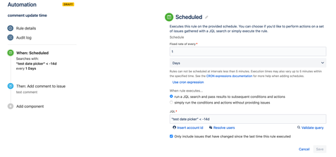

Indeed, the Updated field considers any field update in the issue, however, you could use another date custom field and second rule to get that field updated with the current time when an Issue is commented. These would be the Steps:
  1. Create a new date picker custom field and add it to your project screens, but not adding it to the view issue screen to avoid your users to accidentally populate it
  2. Create a new rule to automatically update the field with the current date when the issue is commented by the reporter:
  3. Create the rule to add the comment as you need:
  4. P.S: Make sure you allowed the second rule to be triggered by the first one, under the Rule details.
