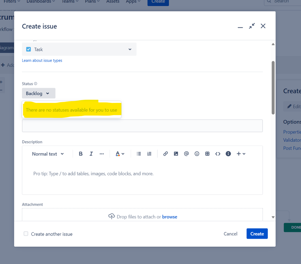

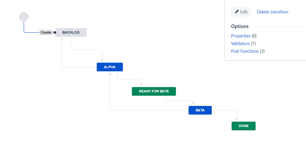

Currently, when I or my team members create a new issue, it can only be created with a status of Backlog. When I try to reuse the Create transition for the Alpha status (see workflow diagram) Jira does not allow it to be attached to more than one status. I know you can have "allow all statuses to transition to this one" but that contradicts the workflow I am trying to instill.
Does anyone have any suggestions for how I can select a status of Backlog OR Alpha (see workflow diagram) at issue creation?
Thank you!

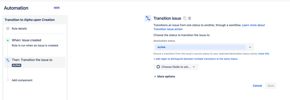

With that said, my recommendation would be to create an automation rule with the following configuration:
Trigger: Issue Created
OPTIONALLY: -Add a condition IF when you want an issue to actually go to Alpha status
Action: Transition Issue

When you are in the Create Issue dialog, where it shows the pull down field for Status and you currently see Backlog, that field will list all status in the workflow (for that issue type) that have an incoming Global Transition. An incoming Global Transition means that an issue in any status in that workflow can be transitioned to the destination status. A Global Transition looks like this:
Note that the transition also cannot have any Conditions or Validators as part of its configuration.
On a side note I see that you have defined your "Ready for Beta" status as part of the "Done" Status Category. It is a bit unusual to have an issue transition from an "In Progess" type of status to a "Done" type of status, then back to an "In Progress" type of status, and then again to a "Done" type of status. Is there a reason you made "Ready for Beta" a "done" type of status?
