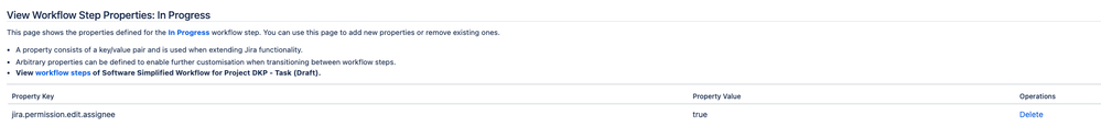

Please set the properties as follows on your status.
This will limit editing the issue in the status in progress to the assignee only. If the issue is not assigned the edit action will not be saved.
Marcin Kupisz
January 9, 2024
It worked :) Thanks!
