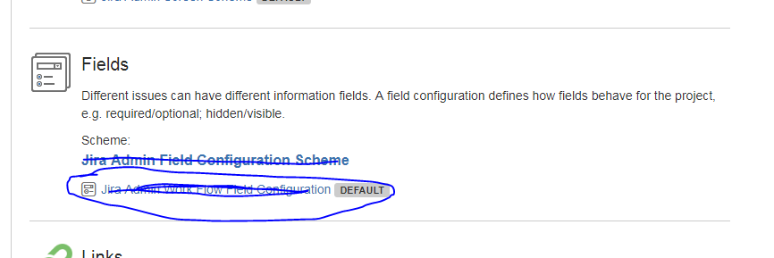

Your project would be using some Field configuration.
Go to Project's Administration, and see what that is.

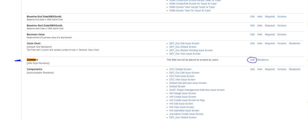

 Search for Comment in the fields. And select Edit to add the script over there.

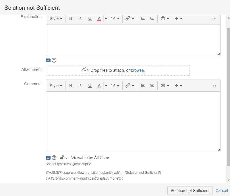

Jakobi Oommen
September 20, 2017
I added the code to "explanation" and "comment" fields separately but all that happens was the code appearing in the description.
