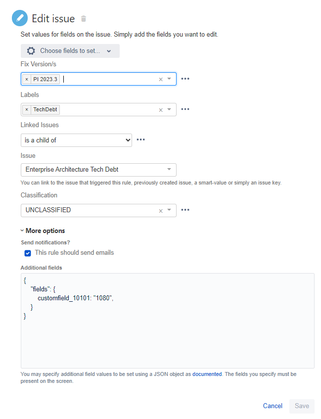

@Bill Sheboy  Thank you for responding. I tried using the following JSON but not sure I wrote it down correctly as it's not working. I get a failed message each time. The following fields should be filled out (below) in addition to the Team field.  I have tried using the team id as well as the team name. Still not working. Would love the help!
"fields": {
customfield_10101: "1080",
"fields": {
customfield_10101: "DTO - Systems Engineering",
Isabella Musial
August 30, 2023

Isabella Musial
August 30, 2023
@Bill Sheboy  Thank you... I really appreciate your help troubleshooting!
Unfortunately that didn't work either. I copied directly from your response.
I've tried using the customfield_10101, "Team" as well as "1080" and the actual team name. No luck.
I have faith in Jira that I can do this, but I am not a JSON expert by any means.

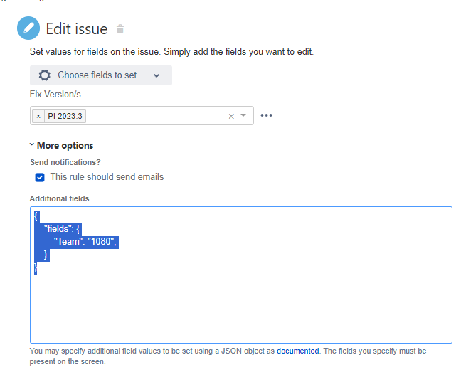

Should I put the JSON in its own "Edit Issue" component so it's standalone? I found that if I add too many fields into the component, then they don't update the jira issue.
Bill Sheboy
August 30, 2023

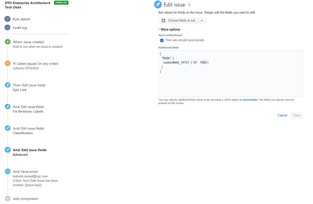

Hmmm...I wonder if there is a different issue related to your rule structure.
Would you please post an image of your entire rule, and include an image of the edit issue action?
Isabella Musial
August 30, 2023
Bill Sheboy
August 30, 2023
Yes, that helps; thanks!
When you edit an issue in a rule, particularly the trigger issue, it is using the current conditions at the time the rule was triggered.  If you want to include the latest edits, each edit must be followed by the Re-fetch Issue action to reload the information before the rule proceeds.
Because each call to Re-fetch Issue can add about one second to run time, it helps to consolidate your edits to one action, when possible.  Let's try that first.
If you have multiple edits requiring JSON, let's look at how to merge those into one action also.

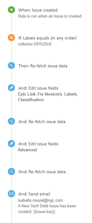

Isabella Musial
August 30, 2023
Ok, that worked.

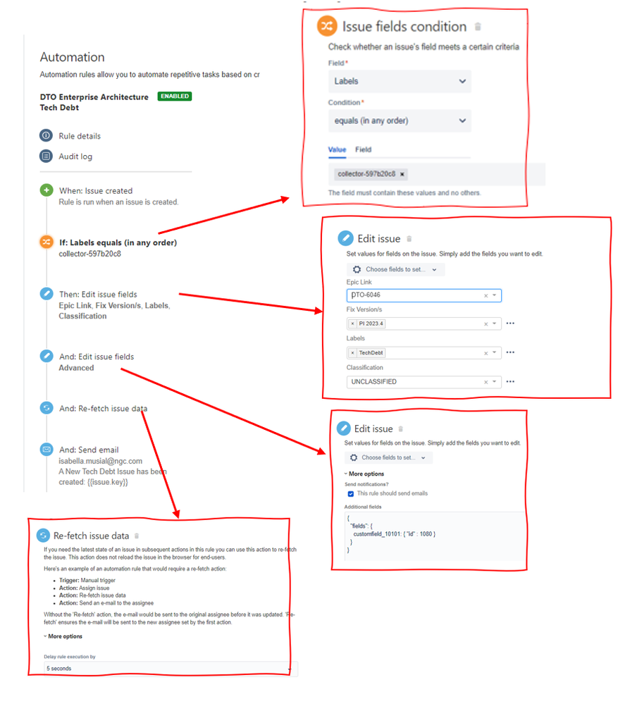

Bill Sheboy
August 30, 2023
Would you please post an image of your current, complete rule...including details of the action to set the team?  Thanks!
Like Isabella Musial likes this
Isabella Musial
August 30, 2023
Bill Sheboy
August 30, 2023
You are missing 2 calls to Re-fetch Issue...
Add one immediately after the trigger, and before the condition test
Add another after the first edit issue action.
So the rule will look like this:
  • trigger...
  • action: Re-fetch issue
  • condition...
  • action: edit issue for Epic Link, Fix Versions, Labels, and Classification
  • action: advanced edit for the Team field
  • action send email
