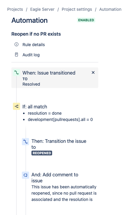

@Magdalena Zhisheva not the exact same scenario which you're looking for, but I created the following rule which reopens tickets with no associated PRs and resolution done.
Not sure it's the best way, but it's working..

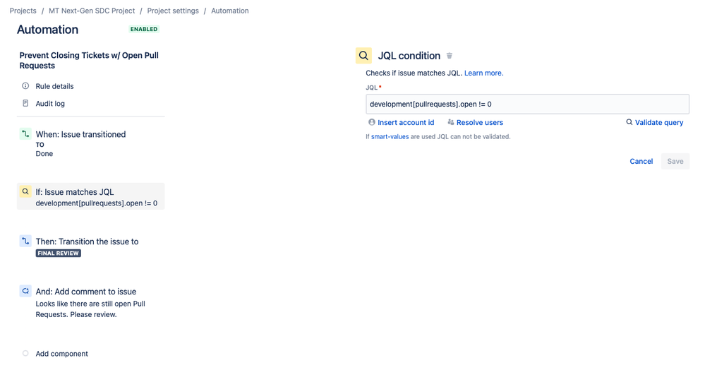

I were able to build the following rule and seems to working for now for two teams in our instance:
Hope it will help someone :)

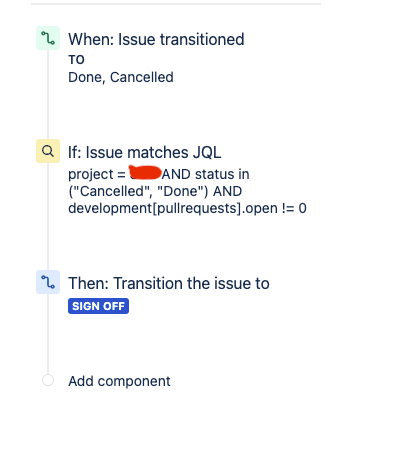

Michael Trieu December 29, 2022
Works for me! Thanks!
girish_nagappa January 30, 2023
Hi @Michael Trieu
Can you help with the condition you have used to achieve this purpose?

Michael Trieu January 30, 2023
Hi @girish_nagappa
I used the same one as posted above
development[pullrequests].open != 0
