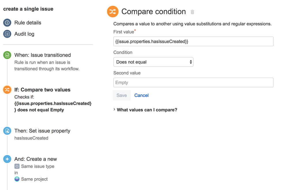

You should be able to do this with entity properties, so when you transition the epic, you can mark with a property saying that the issue has been created, preceding that you check the non-existence of that property. Here is an example:
Let me know if that will work for you.

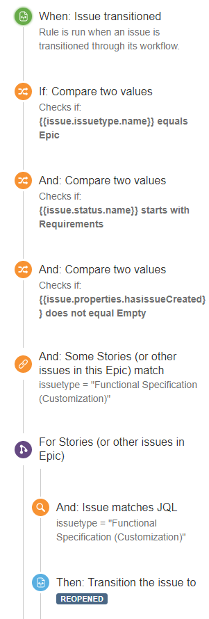

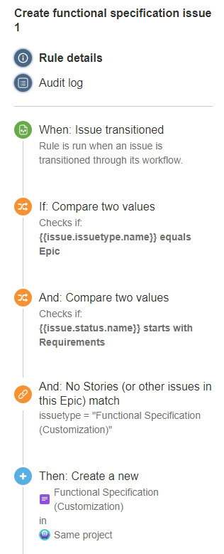

I went about this in a different way as I got stuck if a user manually deleted the issue (and i did not want to add another automation to clear the hasissueCreated property.
My solution was to create two automations.
1. Create issue if the issue does not exist (using the related issue condition).
2. Reopen issue if the issue does exist (using the related issue condition).
