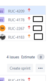

How can I make estimate bubbles appear on the backlog view of a scrum board?
Anastasiya Kruchkevych
June 4, 2020
I added Story point estimate: to tickets but these don't show in the backlog view next to the tickets and don't get calculated into the common sprint estimate. How could I fix it? TYIA

Hello @Anastasiya Kruchkevych
Sorry to see you are facing a problem to estimate your board.
Can you confirm if you are using a Classic or Next-gen project? The behavior you are facing typically happen when you select the wrong field to estimate your Story points. Explaining better:
JIRA has just one specific field to track the Story points for each project type (Next-gen or Classic), and a different field will not work:
- On Classic projects, the estimation is measured on the Story Points field
- On Next-gen projects, the estimation is measured on the Story Point Estimate field
That being said, if you are using a Classic project, please use the Story Points field to estimate your issues and completely remove the Story Point Estimate field from your project screens.
Let us know if this is the scenario you are facing.
June 8, 2020
Thank you Petter, the problem is solved now!
