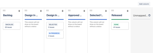

Our team created 5 columns, but only 3 columns show up. From the help doc I read, my understanding is that we need o assign status to the other columns then they will appear. However, as an administrator of this board, I don't know why I don't see the "Add status" button next to the "Add column" button.

Hi Elaine - Welcome to the Atlassian Community!
You need to have a status mapped to the column in order for the column to show up when you view the board.

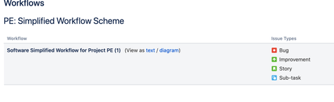

I went to Workflow, but I can only view things. Can't edit anything. (Clicking on the diagram can zoom in/out to view it). What can we do next?

John Funk
June 17, 2020
You have to be a project admin to be able to modify the simplified workflow.
Or if you are a Jira Admin, then you can go to Settings > Issues > Workflows and modify it there.

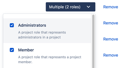

Thought I am the project admin of this board. Not enough?  (I am not a Jira Admin)

John Funk
June 18, 2020
No, you must be a Project Admin or a Jira System Admin
