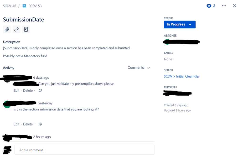

How do I get the EPIC NAME on the ISSUE WINDOW (See screenshot)?
Do you mean the Epic Link? The new issue view is a bit of a challenge for sure. Go to project settings > issue layout. Edit the layout for the issuetype in question, it appears to be Task here. Check for available fields and drag over.
EPIC NAME or something similar isn't available, either as a SECONDARY FIELD or PREVIOUSLY REQUESTED FIELD.
When you click on VIEW ISSUE in an email notification, you don't have a clue what EPIC it belongs to. You shouldn't have to pad the Issue Name with the EPIC NAME just for usability.

It's not within the EMAIL notification that I want this. When our users get an email notification of a new comment on an issue they are watching. They click on the VIEW ISSUE link, and are taken to a view which does not contain the EPIC NAME. four letters and a number is not something you can instantly translate to a real name.
I've just realised that I can hover over the EPIC LINK, which does reveal the EPIC NAME, but you should be able to have the actual EPIC NAME list in this view. Do you know how?
"Epic Name" belongs to the Epic issuetype only. What you can do, as I showed above, is to include the "Epic Link" and I expect that would meet the requirment. The "Epic Link" is not just some url it conveys in words what the epic is.

The Epic Link is already present but is just the random letters, here is an example:
SCDV-73 / SCDV-811
The 'SCDV' part is the code for the Project, under which there will be 20 EPICs (including SCDV-73). To find out that the epic it refers to is 'ACCOUNT' I have to hover over the link and wait for it to appear.
My issue is that 'ACCOUNT' should be displayed by default without needing to hover.
