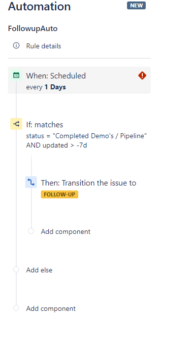

I have attempted to create the following:
However, I received the following error message:
Error
  • The rule has been configured with components that require issues to be provided by the trigger. You need to use the option to run JQL to provide issues. The following components require issues: JQL condition, Transition issue

Hi @Oliver Warren  -- Welcome to the Atlassian Community!
If you look at your rule where it shows the error icon (red exclamation point) and the message, it is telling you that you need something for the scheduled rule to process, such as JQL, because the rule touches issues.
Please try adding the JQL that @Jack Brickey suggests to the trigger: rather than putting it in a condition:
  • trigger: scheduled with JQL... status = "Completed Demo's / Pipeline" AND updated < -7d
  • action: transition the status

December 16, 2020
Perfect! Thank you!
