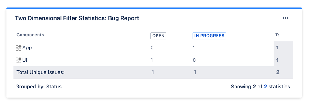

Hi @Balamurugan ,
You can use below query and save. Use the filter in Two dimensional filter statistics gadget in Dashboard.
project = Test AND issuetype = Bug
Sample Report looks like below:
Screenshot 2019-10-30 at 1.30.58 AM.pngThanks,
Avinash

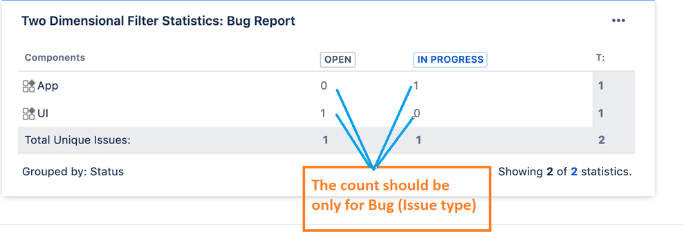

Balamurugan
October 30, 2019
Thanks Avinash.
I have done that already. However It shows all the Issue type.
The above one shows in all the issues like (test, story, bug, sub task).
I need only the Bug list with different Status.
Like below : Components in y axis

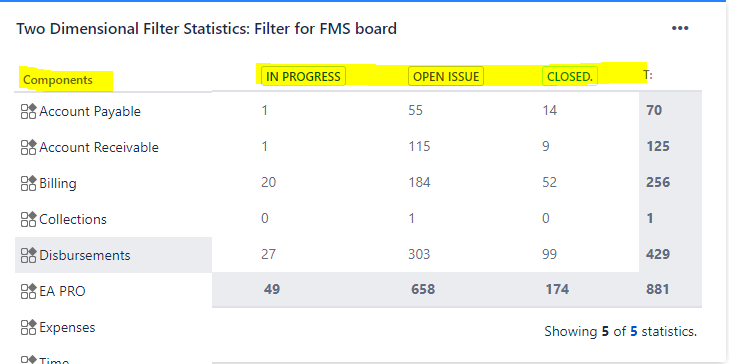

Avinash Bhagawati _Appfire_
October 30, 2019
Hi @Balamurugan ,
Currently you are using board filter which gives you all issues list.
create below JQL filter query and add it to Two dimensional Filter Statistics gadget.
Please click here to know to create filter in JIRA.
