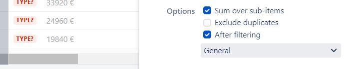

Hello @Dionathan Lopes {ALM Works}
thanks for your support. This helps. Now, I am able to show numbers in a currency format. However, this is only possible as long as I do not use "sum over sub-items".
Using the "sum over sub-items" as well as "after filtering" would be my preferred solution.
Do you have an idea?

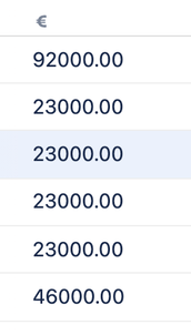

Hello @Thomas Fischinger
In this case, I'm afraid that the CONCAT will not be able to help with the € symbol, but, you could try to use your formula as it was before:
IF type= "Project":
effort_intern * 800 + effort_extern * 1000
You could also change the format from General to Number with 2 decimal places, and then change the Formula Column name to "". You should see something like:
Please let me know how it goes.
All the best,
Dionathan L
