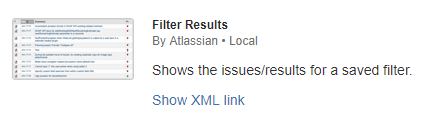

Which dashboard gadget are you using to display these Jira issues?  I'm curious if perhaps there is a documented bug in that version of jira.  As far as I can see from your JQL, it looks fine.

In the boave query you can use your username as well instead of "currentUser()". This query will fetch issues assigned to you and without labels. You can save this filter and then on the dashboard use the "Filter Results" gadget to fetch issues from the above filter.
