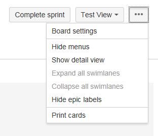

How can I enable the option to expand swimlanes on a board?
Liz O'Connor
January 17, 2018
We would like to use swimlanes on our Kanban board, but the option to expand them is disabled in the board menu.  How do I enable it?
Thanks!
Liz

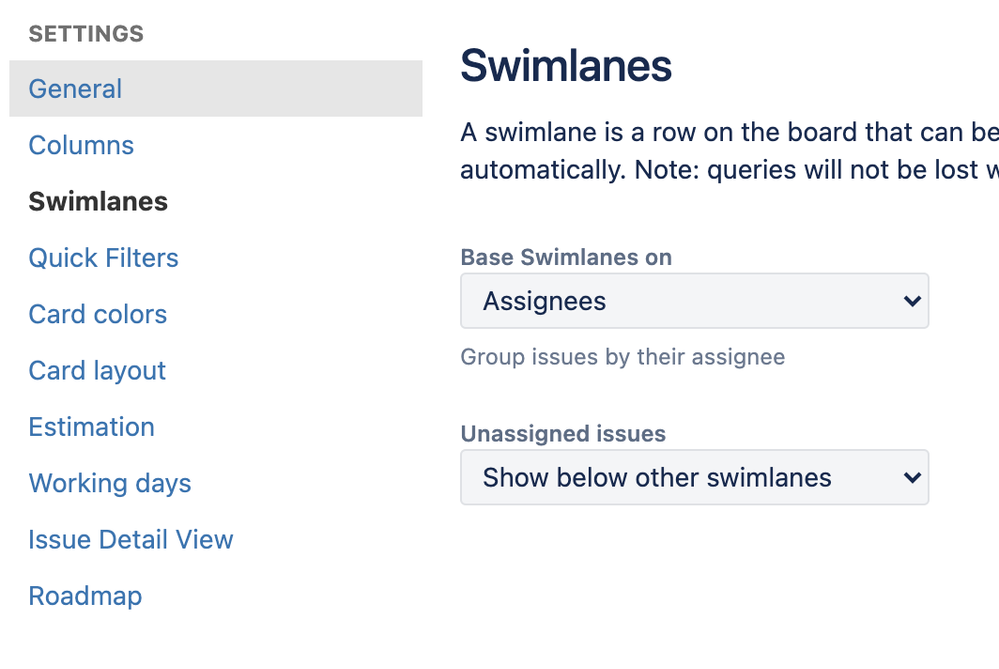

nereida.restrepo
August 6, 2021
Hello All,
I was having the same issue and now I'm mesmerized of how simple the fix was:
Simply go to your board settings > Swimlanes> Based Swimlanes by assignee.

Jack Brickey
January 18, 2018
Do you have swimlanes defined? Do you see more than a single swimlane today?  If not go to board setting and swimlanes to set them up.
Liz O'Connor
January 22, 2018
Hi Jack,
In Board Settings under Swimlanes I have 'Base Swimlanes on Stories' selected from the drop down list.  Where else do I need to enable it?  The stories in the sprint have subtasks, but no swimlanes show currently.
Thanks,
Liz
Jack Brickey
January 23, 2018
your original post did not convey that you are setting up swim lanes by stories. Indeed if that is your intent then that is all you need to do to get story swim lanes.
Can you provide an image of what you see? Stupid question but, do you have stories created?
Anna Muradyan
June 21, 2018
I have the same problem.
The Board configs are set as "Base Swimlanes on Stories", but "expand and collapse all swimlanes" are disabled.  Apparently I'm using Scrum board.
I have Stories that have subtasks. My goal is to see the subtasks in the Board. Currently I see only the Stories.
Daniel Roussel
July 16, 2018
I had the same problem and then, while trying to fix the problem, I realized that I changed the board query to include the value of a Team custom field we added to issues.  The thing is, stories, bugs, tasks, etc do get a value so that they appear in each team's board (everyone is under the same project). But subtasks do nat have a value assigned for the team field, so they were simply not returned in the scrum board and thus, no swimlanes to display.
To check if the problem originates from there, I would suggest going into the board's filter edit mode and make sure that subtasks are actually part of the result.
